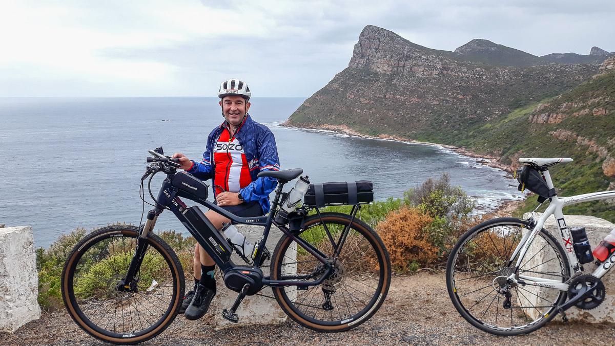

I was putting too many km on my full suspension bike, thus bought a HT for road riding.1459177765_CTCT2022-3.jpg.6b58ca2d05bbb1f36c9b6f199bd70bd8.jpg
I am running 700C50 gravel tires on it.  Certainly less drag.  But your top speed - on down hills - is limited by gearing, thus I am now running a 38 in the front.
The carrier was installed for the commute.  I then made a "bucket" that holds the spare battery.  Certainly nice to not have to carry it in a backpack.

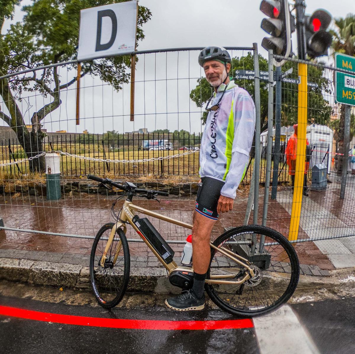

Met this gent at the start, riding the same bike - .  He was confident of completing the 109km on a single battery ....  According to Gert some 9 Darrvin e-bikes were entered for 2022
This couple from Bloemfontein were also doing the CTCT on single batteries.  The gent has done the ride many time before on a road bike.  This was their first time doing it together.  Also on a single battery.

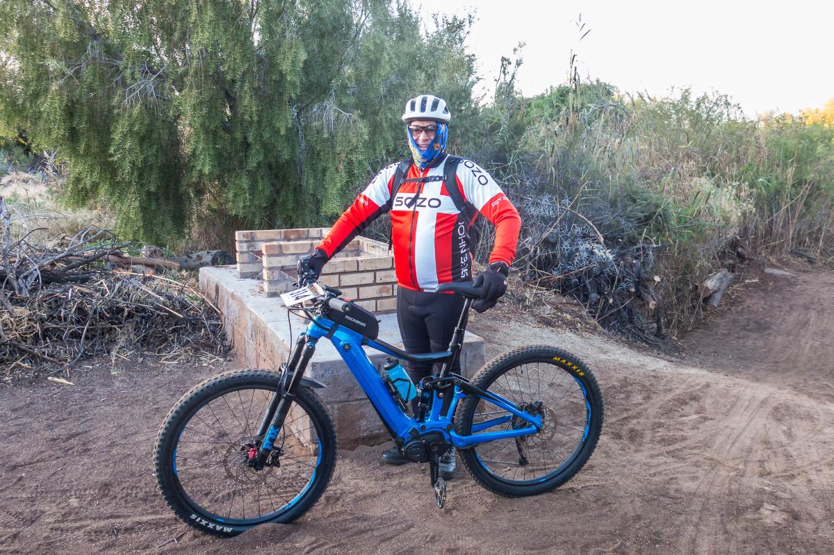

This is me at the start of the Trans Augrabies .... dressed for the 4 degrees .... back-pack on with the spare battery.  Only later found out they transport the second batteries to the mid water point, and bring back your battery at the end of the day.  Vines-and-Views offer the same service.  Only the Swartberg event that does not allow a spare battery, and restricts ebikes to one of the routes only.
