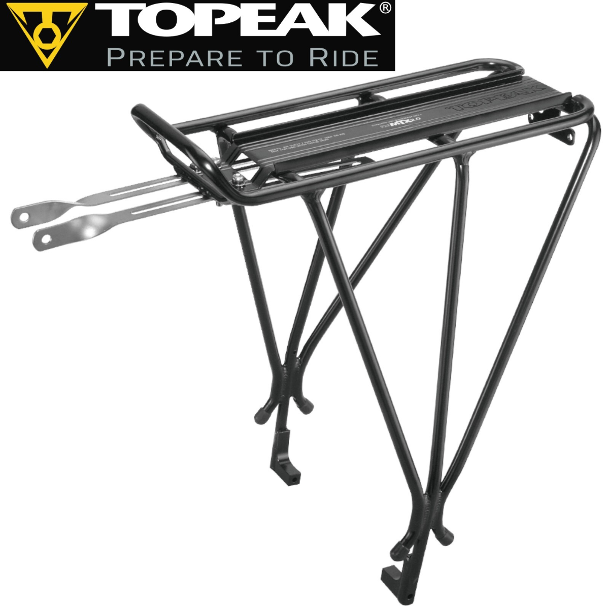

A bog standard steel tubular rear rack can be fitted to almost any bike, steel, titanium or carbon.

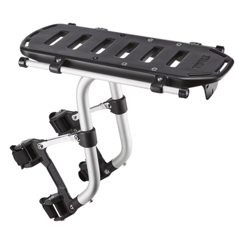

image.png.a223abed53b97b5f29fe94eda83c9c84.png Obviously it helps if your bike has mounting points on the seat stays or mounts directly via rear axle like the Tailfin, but if there are none, you can get temporary mounts or the rack has mounts that fit directly to the seat stays...eg Thuleimage.png.21c5418ef60f81ef1c2b80bf3367f314.png

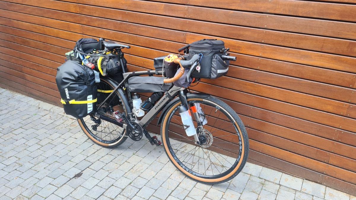

Here is an el-cheapo ally tubular rack like that Topeak above (Giant rack) fully loaded with Thule panniers...you can't even see the rack! Bike has mounting points....No mechanicals...I did lose a mount bolt at the right axle side and only noticed after 5 days of gravel...the rack never twisted or buckled at all! just some minor scuffing at the mount point and easily secured with duct tape and cable ties!!!
