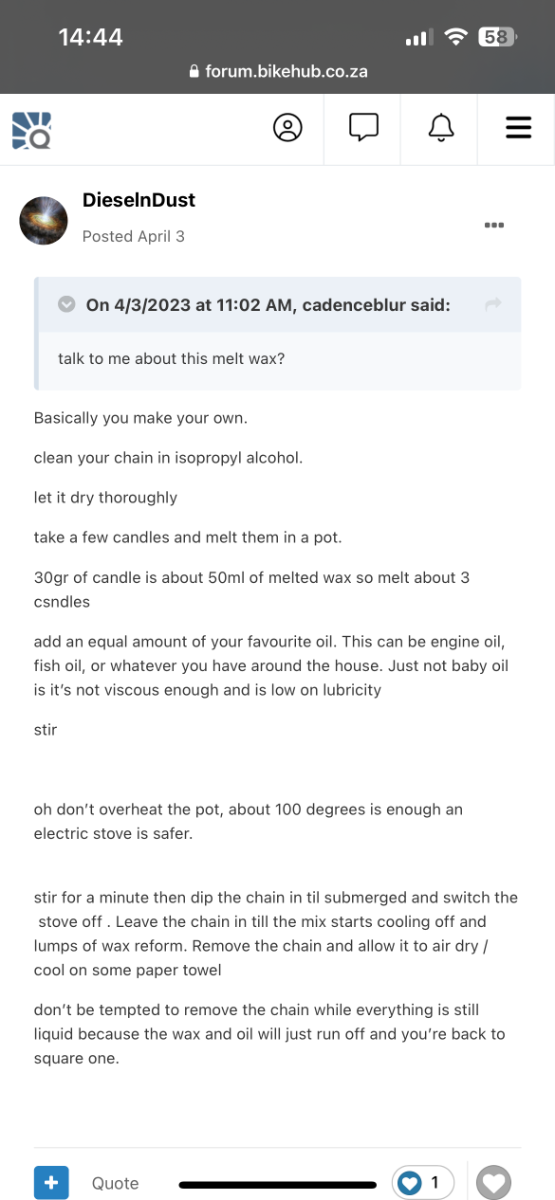

  13. Using the same wax, will give it another dip later after adding some more wax to the mixture.
  14. I did that but it wasn't solidifying, eventually removed it and hung it up, still soft this morning
  15. Thanks will dip again
  16. A question for those that wax their chains.. Did my first attempt and the wax has dried but the chain is not stiff as I've seen in some videos, Does this imply that my mixture was too oil heavy? Thinking of redoing it but with more wax? Using reitzer’s oil by the way.
