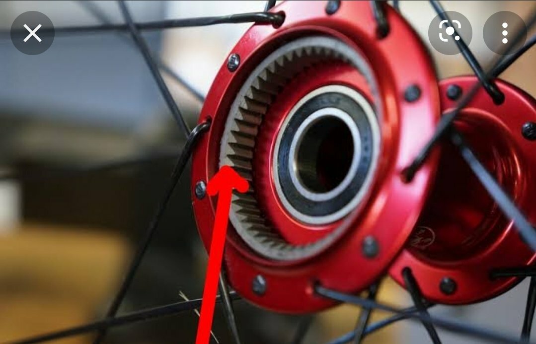

  15. I have gone the warranty route, to check with them. If not successful then will attempt the epoxy root If that fails epoxy fails, potentially 50/50 but I'm doing it for the greater hubs interest. Then meantime scout around for hub deals
  16. I see getstoked having sale on dtswiss, so I shall be heading that route. Just doing some research
  17. I took the suggestion to my lbs and they advised the same, epoxy will work but they doubt it will last long. So I am on the hunt for a new hub, wont risk 2nd hand just incase same crap pops up again. 3 weeks ago, snapped rear derailleur, now a broken hub. ???? The hobby that loves our wallet as much as we love the hobby ????????

  19. I think I will attempt this instead of paying Btwn R2500 to R5k for new hub ???????? This will be my last option, thanks Definitely will try this Wish me luck

  21. Hoping the wise hubbers can help I have deeds hub 6 pawl hubs that are not engaging when I pedal. Removed the hub to check if hub was gunked up or not moving freely etc. We did all the basic checks of the pawls and springs and they all move as they should but the ratchet teeth in the hub also moves, which I doubt that it should. As I back pedal it moves perfectly and noisy as usual.lol This pic is for reference, to show what part is moving. Should it ? If not why would it rotate and feels fairly stiff as it rotates Then pic of the deed hub, can't find too much info on the web about deed hubs.
