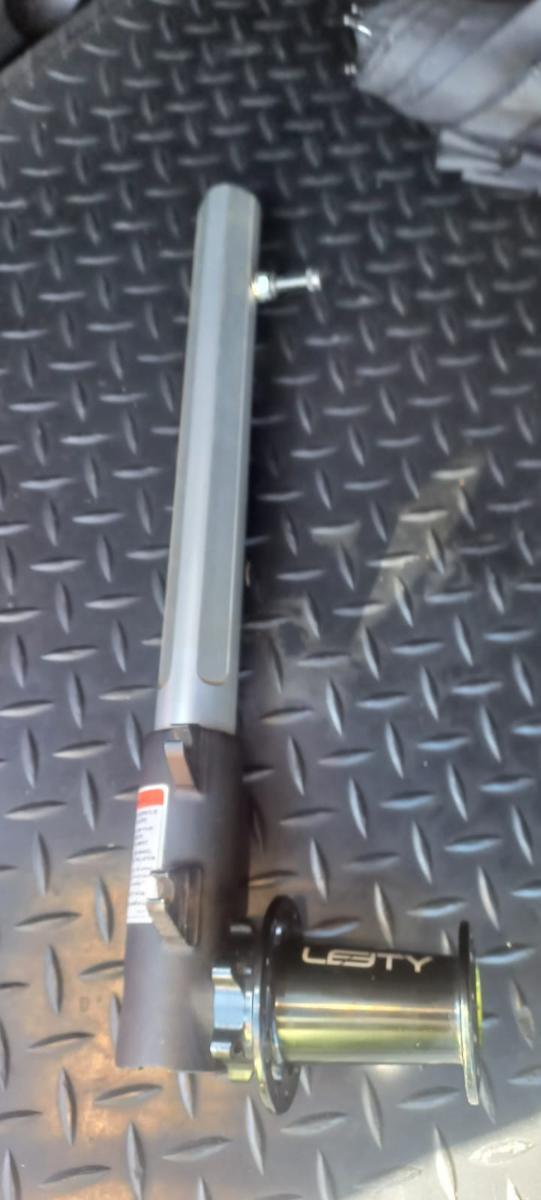

On 4/29/2025 at 6:20 PM, NotSoBigBen said:
Finally getting down to sorting the Lefty stuff for my gravel bike.Β
Thanks to advice from Grumpy I dropped the fork off at a local engineering guru to have the spacer made, provided the dimensions from @Mongoose!, thanks again mate. He says it'll probably be ready tomorrow 😎
Have to build a wheel .... That'll happen over the next few days. Bloody hell Grumpy has some cool cool stuff!
Β
Demmit, fricken heck .... after all the excitement of collecting the necessary goodies from the engineer chap and ready to build a wheel and install turns out the hub I managed to get is for a 2.0 fork not my 1.0 😨 (ja ja Grumpy did warn me to check that first)
So now on to finding a 1.0 hub or wheel 😎
