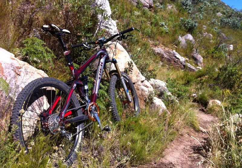

Finally got the new trance dirty! I was apprehensive of the big wheels. All I had was a big smile!
I rode mine this weekend too. I found that I immediately felt very comfortable, coming from a Reign.
The bike feels very playful, and steers pretty much as easily as the Reign. Grip is excellent.
Only time will tell if the the wheels hold up to hard riding.
