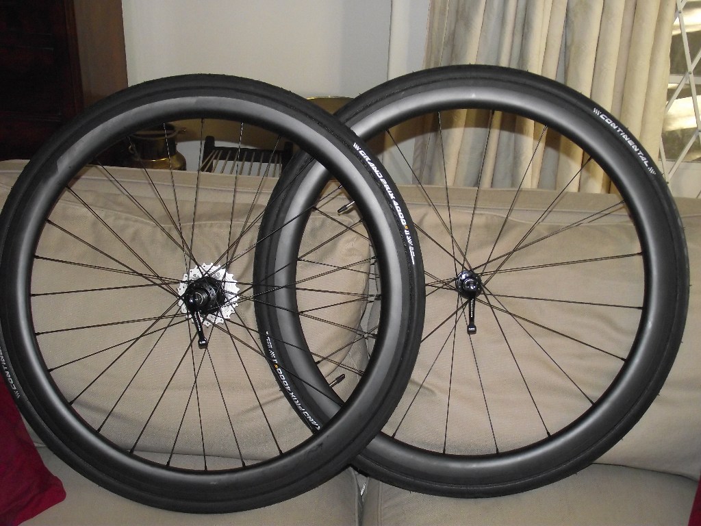

I am building up some U shaped deep carbon rims at the moment.  Supposedly stronger than the usual V shaped of the same weight and initially designed for cyclocross use.  The supplier I have chosen will supply up to 55mm depth and 16 to 36 hole options.  With that you can build one strong mother of a wheel!

I have built rims from www.offthefrontracingsystems.com which are really nice rims.  The ones I have now are from www.light-bicycle.com.  They are also well reviewed.
