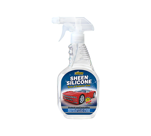

I've used Shield Sheen Silicone in the past on my old fork, but now I've read that any solvents it may contain would be bad for the rubber seals and maybe even the anodizing. Maybe more of an issue with the others in spray cans that use propellants?Sheen-Silicone.png
I've also read that mineral oil can make some rubber o-rings expand, so maybe also not a good choice for forks / shocks.
Edited by MrJacques

Do lowers services with the correct oils and grease at recommended intervals, you don't need to replace seals each time, seals can last for ages.
Using a bit of lowers suspension oil to lube up the stanchions is probably the best thing you can do. Hyperwiper is essentially just that but it has another trick which is the little nozzle the bottle has. With this nozzle you can poke behind the dust seals and actually get oil onto the foam rings.
