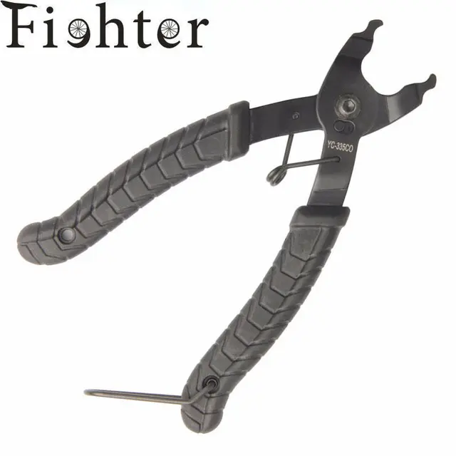

Or alternatively, just get the right tool for the job. They are not that expensive.
One like this you can use to fit and remove the link in a few seconds.
BIKEHAND-YC-335CO-Bike-Bicycle-Chain-Qui
