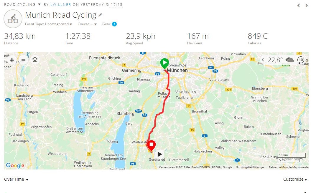

As an example, my distance was 48.6km and one of the others was 47.1km.
This made me wonder so I had a look on my own recordings.
Picture A
Picture B
Picture A was yesterday with my MTB.  No Garmin speed sensor.  Only my Garmin Edge 820
Picture B was on Thursday last week on my Road bike.  Garmin speed sensor.  Exactly the same route but 100m more.
Picture A
Picture B
100m is not much, you can probably attribute that to how turns were taken, where you swerved, etc etc.
Yip or the cycling paths in the city that might have slight deviations in the inbound and outbound route.  So the two give pretty much the same reading.
