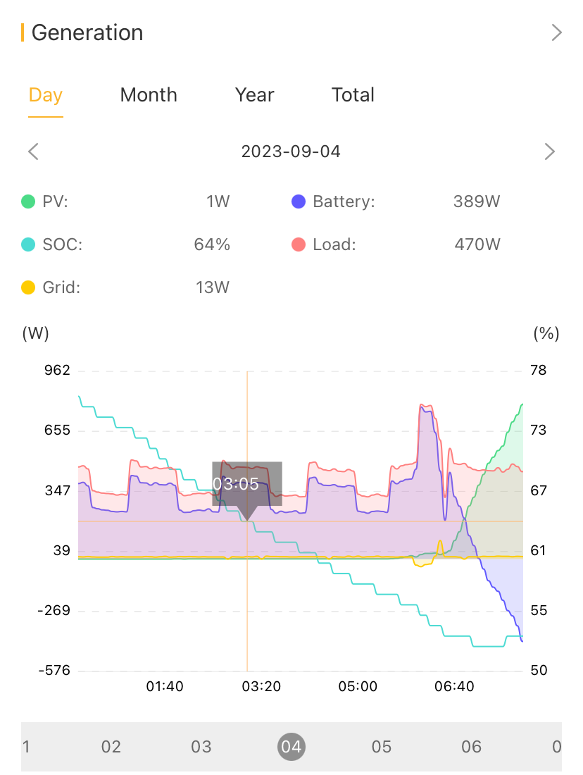

My low demand power overnight ranges from 350W to 490W per hour. This is for fridge, alarm, 2x routers, one outside light, appliances on standby and charging (computers). Assume the mid-point, 420W per hour, equals 10kWh per 24 hours. This is 50% of my daily usage (18-20kWh).
Then add the on-demand items:
Pool (0.75*4.5=3.3kWh)
Dishwasher: 1.2kWh
Washing machine: 0.8kWh
Geyser: 3-4kWh (0:45 to 1 hour)
TV/lights: 2-3kWh per day

On 7/15/2022 at 7:36 AM, Dexter-morgan said:
As posted on another thread, 3kva(2400w) inverter, with 2 x 100AH deep cycle Gel batteries in series for a 24v system, it is fully automated, I do not even know when the power goes off a small beep from the garage where my DB is located, I have used the dishwasher and washing washing at the same time with no issues, I have not seen the batteries anywhere below 70%, the best money I have spent, the whole system cost me around R14k and did all the work myself. Have to add the inverter is Solar ready with a built in 30A MPPT
how did this work for you this past week with the substation issue ?
