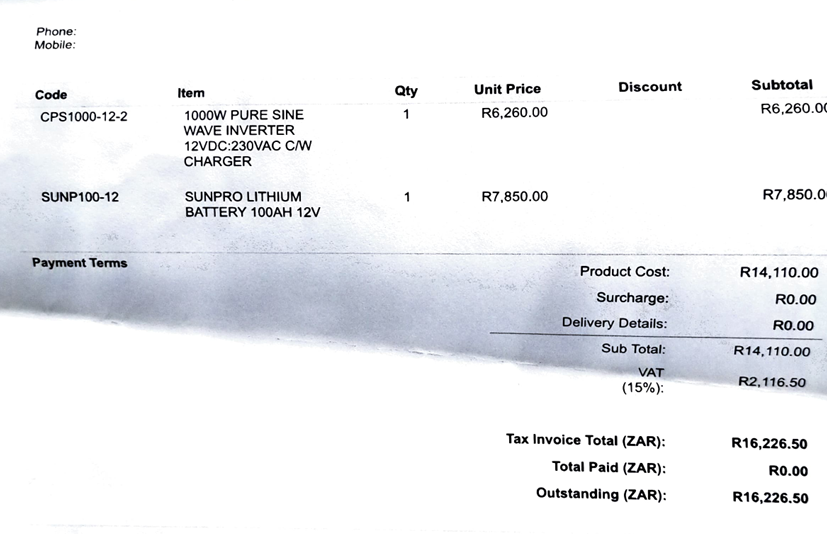

Hairy Posted February 28, 2023 Share 20 hours ago, Hairy said: Sooo ... any of you riff raff using a Synapse 600W Sine inverter? We got one for my home office (Running PC, monitors, Interwebs McGuyer that brings and distributes the world wide web in our house) about a year and a half ago with a 12v 100Ah Lead Acid battery. The ACDC guy notes that the Synapse 600W inverter that I have has a rather good charging capacity at 20Amp at 50hertz, so this would be able to accommodate a Li battery. Seeing as this is not being paid with the change found “under the sofa” I want to make 100% certain via another source (THAT IS WHERE YOU RIFF RAFF COME IN) if the Synapse 600 can really charge up the Li batteries. Short term the LA battery will work, but given the short recharge cycles and then the usage after not having a full charge will kill the battery again in a short period of time. The 100Ah Li battery would be the better solution given the above. If one looks at going larger with the LA battery at 200Ah, you are at the same price as a 100Ah battery, with double the energy capacity where in theory after a long discharge would still leave a reasonable % of charge in the battery which hopefully will help with it’s life span. The Li though will charge up very quickly and more efficiently, and be ready for the next stage of load shedding. 1st prize (Following alternative confirmation that it can charge Li) would be the 100Ah Li battery. 2nd, the 200Ah LA battery … given the price, you may as well go Li 100Ah 3rd , would be the 100Ah LA battery. The info I can find on the inverter so far https://www.solarpanelenergy.co.za/p/982764/600w-12v-synapse-ups-inverter This battery is kaput, and I am looking at alternatives as per the following: Anyone? Link to comment Share on other sites More sharing options...

PhilipV Posted March 4, 2023 Share On 2/27/2023 at 6:45 PM, Hairy said: Sooo ... any of you riff raff using a Synapse 600W Sine inverter? We got one for my home office (Running PC, monitors, Interwebs McGuyer that brings and distributes the world wide web in our house) about a year and a half ago with a 12v 100Ah Lead Acid battery. The ACDC guy notes that the Synapse 600W inverter that I have has a rather good charging capacity at 20Amp at 50hertz, so this would be able to accommodate a Li battery. Seeing as this is not being paid with the change found “under the sofa” I want to make 100% certain via another source (THAT IS WHERE YOU RIFF RAFF COME IN) if the Synapse 600 can really charge up the Li batteries. Short term the LA battery will work, but given the short recharge cycles and then the usage after not having a full charge will kill the battery again in a short period of time. The 100Ah Li battery would be the better solution given the above. If one looks at going larger with the LA battery at 200Ah, you are at the same price as a 100Ah battery, with double the energy capacity where in theory after a long discharge would still leave a reasonable % of charge in the battery which hopefully will help with it’s life span. The Li though will charge up very quickly and more efficiently, and be ready for the next stage of load shedding. 1st prize (Following alternative confirmation that it can charge Li) would be the 100Ah Li battery. 2nd, the 200Ah LA battery … given the price, you may as well go Li 100Ah 3rd , would be the 100Ah LA battery. The info I can find on the inverter so far https://www.solarpanelenergy.co.za/p/982764/600w-12v-synapse-ups-inverter This battery is kaput, and I am looking at alternatives as per the following: I'll take a stab. The 20a inverter can only charge at 20, wether it's into a lithium or a SLA battery. So in 4hrs of charging it will put back 80s, irrespective o wether it's into 100aH LiPo or 200aH SLA. Now here is where my knowledge gets shaky, but Lithium batteries charge at a different profile and higher volts than SLA, so an inverter originally specced for SLA won't be charging the Li optimally or even correctly, possibly damaging it? I think the salesman is talking porky pies. But you'll need to do some research on it. Methinks you are asking too much of your system. Left fuels idea: Buy the 100aH battery, and add a solar panel and solar charger to it, that way when it's loadshedding the battery is charging and solar can even carry the load. Link to comment Share on other sites More sharing options...
