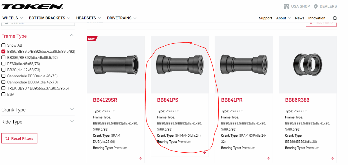

Rather go with this and either Bike Addict or Price Match at Cyclelab ..cost me R590 yesterday. Been riding one for 5 years and 13000km. I just change bearings.Screenshot_20230615_092008_Chrome.jpg.06d6520d2a93ec0c677308a42a5c837d.jpg
That’s GXP and these things don’t last.
Best to go next time is the Token 24 mm that comes with the GXP adapter.

6 hours ago, love2fly said:
Doesn't the Sram have 22 and 24 and the plastic insert on the DS to bring it down?
The bearing on the GXP aside of the Sram BB has a smaller ID
I got a Token in at the moment and when it started creaking I was concerned but when I opened it up the bearings was still perfectly good, smooth with zero play.
After I cleaned & greased its 100% now.  My LBS installed it for me a few months ago and since I didn't know the Token brand at the time I was a bit skeptical.  The LBS didn't torque my crank properly and it came loose after only about 30km, hence I was even more skeptical.
But the Token BB seem to be OK regardless.  Let see how long before it start irritating me again with some creaking ... 🤪😂
GXP is very flawed in its design.
When Truvativ introduced it, the design was groundbreaking, and then Shimano responded with their Hollowtec, to this day trusted and proven.
The GXP takes all the load bearing on the non drive side, which wears that bearing prematurely quick.That and the fact that the tolerances on that bearing is not great.
The Token BB uses 24 mm ID bearings on both sides and then supply a beautifully machined adapter with very tight tolerances. The insert sits internally and spreads the load across both non and non drive side bearings more evenly.
Mine do not have that spacer/adapter .... 🤷‍♂️ (as far as I know anyway)
If the bearing ID is 24mm both sides why would you need a spacer/adapter, sorry maybe I'm completely misunderstanding ...
Never mind, just realized you need the spacer if you have a GXP crankset, I dont however since its 24mm both sides, crank spindle & BB.
