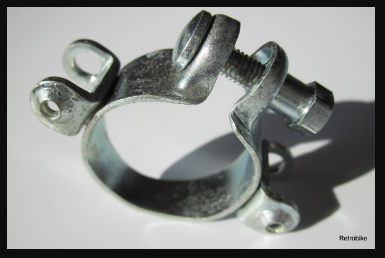

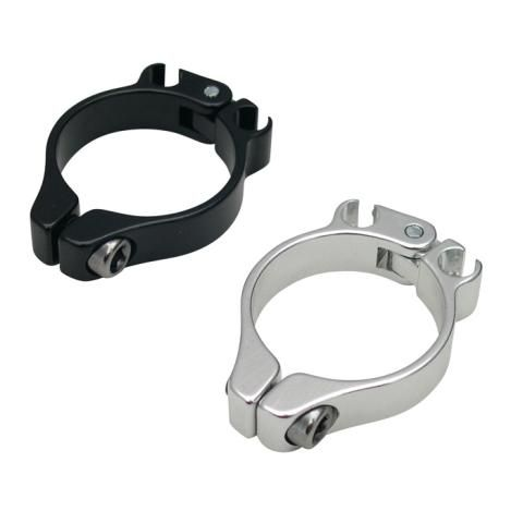

Hi, does anyone have one of these they want to sell? "Double cable stop" for converting vintage steel frames to handlebar-shifters without shifter-mounts on the down tube?
or a DIY hack I can do in the meantime?
thx

18 hours ago, Zebra said:
Buff’s Vintage Bikes to maybe advise you, if Brett/Buff knows?
Cheers
Chris
Thank you, sent Brett a message ... this is the frame I'm busy with. A middle-of-the-range LeJeune, think it's from 74'.
It doesn't have any water-bottle bolts either ... just gave it a quick sand-down, primer, and colour.

Pity you aren't JHB based, could have assisted with adding some rivnuts for bottle mounts, if you don't mind drilling the frame that is.
