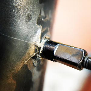

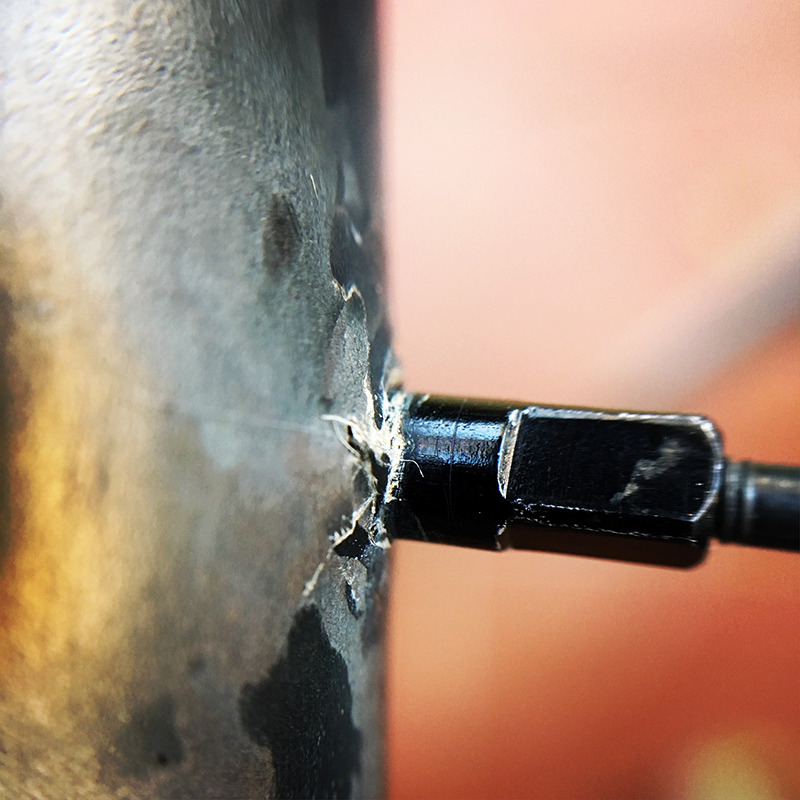

I just thought I'd share an experience with you.
I build a bunch of wheels and also do repairs and rebuilds.
A customer brought a wheel for repair - he was breaking nipples.
The rim is not branded and is laced to a Hope hub.
On inspection I found that the rim was deforming and cracking at a few nipple holes. Upon even closer inspection, I found the spoke threads exposed, indicating that the spokes used in the original build are too short by a few mm. As the spokes were too short, the heads of the nipples were not properly supported and were popping off.
I measured the spoke tensions and they were all over the place, some tensions way too high, and some very low.  I had to decline to rebuild the wheel as I'm afraid the rebuild process, releasing all tension and then adding tension to the rim again will cause it to fail.
I'm interested in your thoughts.
Explain this part to me please? Does the head break if not held by the thread? Never built a wheel, so not familiar with the 'right' way to do it.
In a nutshell, yes. A correctly built wheel would see the spoke thread going all the way through the nipple even by a couple of mm.
