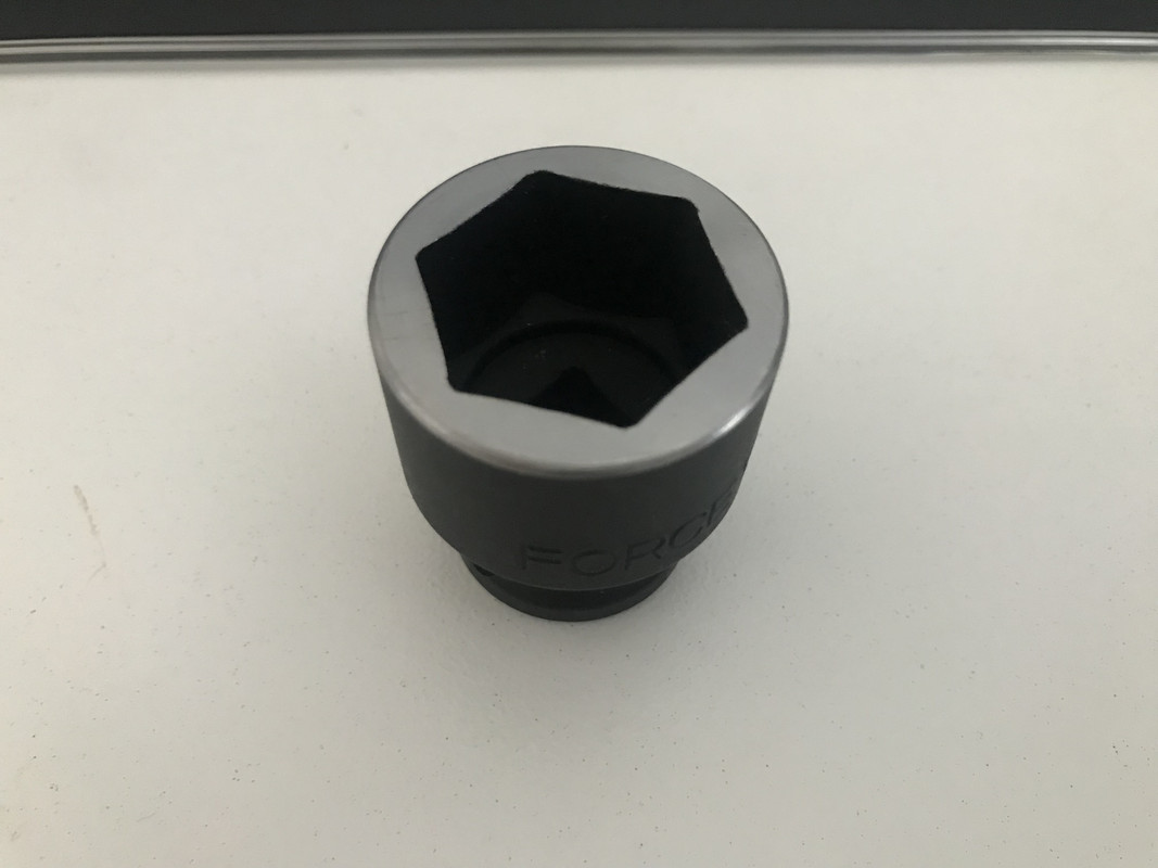

Very easy! First, get hold of a 26mm impact driver socket (example in link below) and take it to an engineering shop for them to remove the chamfer so the socket engages the top cap properly. You must do this or you will ruin the top cap! A friend did this for me, I'll post a pic later!
1. Remove cap
2. Check original air pressure and then let out all the air
3. Unscrew top cap
4. Remove volume spacer
5. Reinstall top cap
6. Reinflate air spring to original pressure. (i do this in 40PSI increments, equalising the fork every time)
Fox instructions:
https://www.ridefox.com/fox17/help.php?m=bike&id=614
Socket:
http://www.forcetools.co.za/12-drive/576-12-6pt-impact-socket-26.html

It is this easy :
start with a HACK ....
Standard 26mm hex socket, on an extention, ground down on a bench grinder  (I did cool it down in water a couple of times.  you dont want to put a heat cycle into the steel...) -
Leaving me with a nasty burr -  :wacko:
But I was ready for this. :w00t:  Now use a cordless drill and a belt sander to finish it off smoothly, and to round the outer edge -  :thumbup:
Hack done, time to get to work removing the "volume spacer"  :thumbup:   :clap:
1) Remove the cap, connect the shock pump, and let out the air (dont get a fright when the front ends starts DROPPING !)
2) Use the 26mm socket and undo the top-cap assembly (turning it out ANTI-clockwise)
3) Remove the top-cap assembly and slide out the volume spacer
4) Turn the top-cap assembly back into place, by hand.  Used the socket for that very last bit only
5)  Use the shock pump to get the shock back up to pressure.  I followed the advise above and increased it to 40psi, then pumped the shock a few times, bit more pressure, pumped a few times, repeat until I got it to 95psi.
PS - the front end DROPS by 80mm when you let out the air from the shock  :eek:
It took longer typing this post than it took to remove the volume spacer !!  :whistling:   (okay, I do type with two fingers, sort off ...)
Hacking the socket, removing the volume spacer and stopping each step along the way to take photos the whole process was less than 45 minutes.  :w00t:
Then the test ride in the driveway .... noticable difference in the open mode !  Not so much in the half-lockout mode.  Cant wait for the weekend to get a chance to TEST it on the trail ....  :thumbup:   :clap:
THANK YOU the_bob !
