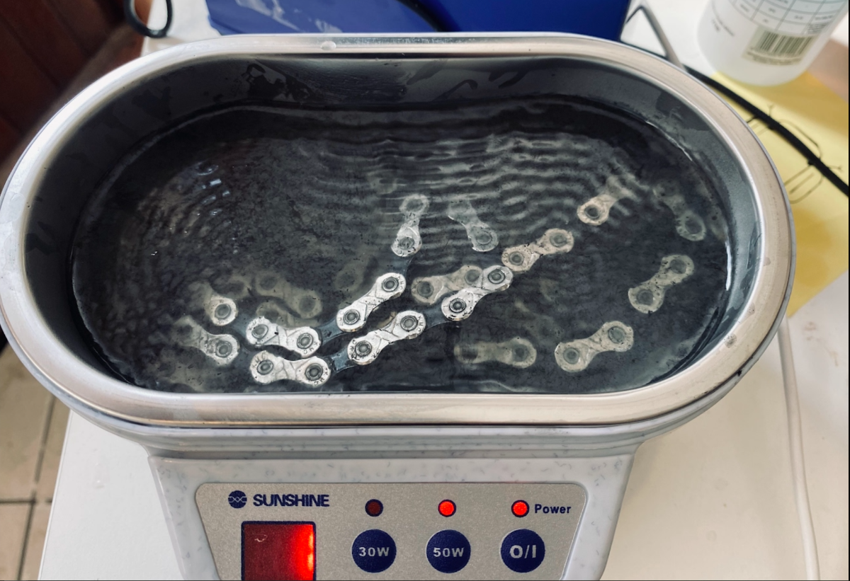

Keen to hear your thoughts on that ultrasonic cleaner
Chain from the trainer bike will be going in straight away, it's in dire need of a clean

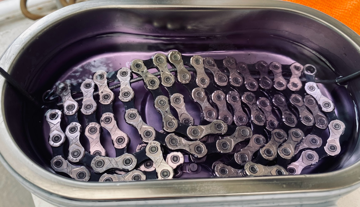

What are you planning on using in the ultrasonic cleaner ? i find cleaning my chain between wax baths being a bit of a pain, boiled water mixes the wax but then doesn’t clean out of the tub I use, so I just end up using my carbs tubs when they’re empty. But it doesn’t really leave the chain clean afterwards
Link to comment
Share on other sites
Is a “shared” purchase between myself and my wife 😂
For her, jewellery, for me chains and other bits and bobs.
based on this article it’s definitely not necessary (but, then again, neither is the whole waxing process 🙈)
https://zerofrictioncycling.com.au/wp-content/uploads/2018/10/Ultrasonic-Clean-Race-Chains-Quick-guide-v3-converted.pdf

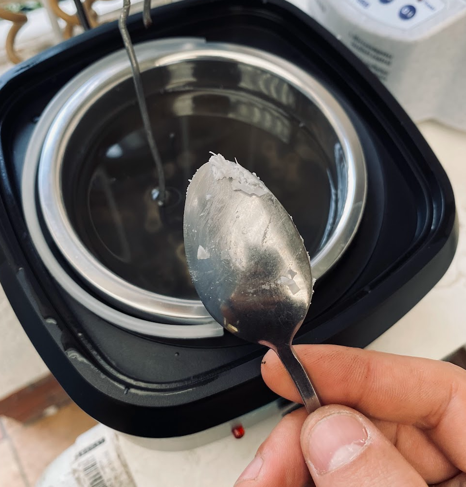

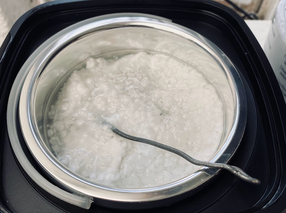

@Jbr when you say ~30% paraffin oil, do you mean you take 70g of the wax pastilles (as below), and 30g of paraffin, and melt that together to make 100g of wax?
Yeah, but very roughly I don't actually measure, I just check how the wax behave when I dip a spoon in and then try to rub it off, I picked it up from a video on youtube, where the guy was showing what kind of texture you're looking for, it must be just only enough that it doesn't just frekle
Link to comment
Thanks. I see you also have the "Pro Wax Heater" from Takealot, what setting do you use?
sdu6rDpFbZpxbdLvt3Ap_wuDHJq2K2xJaNPqNT5LrmZDECK7EWzV6nW0Z5t1HzM5vxMRaO1RbBaMtG-wfFEMTKrIrQWJ3w6m-KONddsNWwxuD8hOisOJj0tzONpOtMfUITnSVyfzMOFSLXX0SexojuGqRgwgFK5ibzzuZb9Wek7_bY5-9McPCwjKaMbaYnY7_KpjvXYTR8Jhdp211bBXTxWvWUWdHibKItBLLaWfHgE6oK1dq3eqzySaXhMzpGopZxe8RKLlNc_xut3Nt0HtJvs4fxI6JUh2R-1WvVyF-rmN-Pj4cjjnYlIjA-ycS4YXM2HjZbtZyCj3P2w2y4TntjSXXGLnXQNDirwPJABH4as5XbrCE9KD27Ie9r2DqzPuD6ZrB90ArXNwbHh51zmCCAVvXN0i2tNHgQDHwXDIIIVRlR3rn_dcr4G8WzRe2Vz7u2o7HI0ete6PyzvFKzkhvyVfFGhYSozwkjhKjz3trv0yXwbuxdl_D_APu-fczhAQveSTSWPgqd1-HGOywaydUIoM0Oh0EeqxoZ5OpzfrgLu0EOB_kGXL-qnmx-NpeIYmyRbnKwQwkFrkk6g5HQHmleSpuS3m5__G3XmAPYmiFP97iOxy_LQ--Q6TOnZzEpL8guu_DZ-QrvMcIOBbvgCy2Aj5cqI7pMOlPHInShQ7wkL9nXUFJEapf4MOyc4beS39nFoqTlh73llqw96n3ixUxlH9SPVsh5s24SUxK75Mu0_axGODxX75oDfowmAVLanqv7uCjrqUr_1WK5VbL27LL02vy0v6_uk2451S0LvfEG-PCwfa4Dm3XeVS-3Jyno4PgJW1Wf3CAatT3-LknHFi8DFU-5mTtJtTqKTvpmiVdU2lzqUkwrxj3v0rTvlkdAqZKNpFngVIlqukkaQkZagHmJPYCdSelS4LZ44kWu9RcZHpbA=w1729-h1297-s-no?authuser=0
Link to comment
I don't know haha somewhere between med and high 🤣

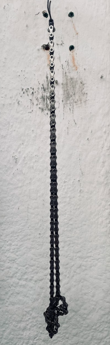

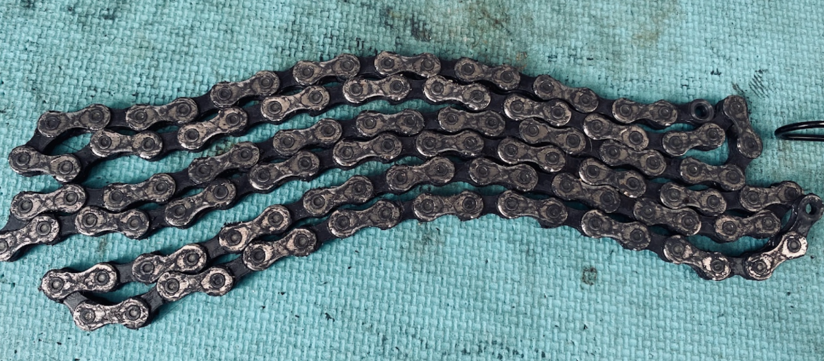

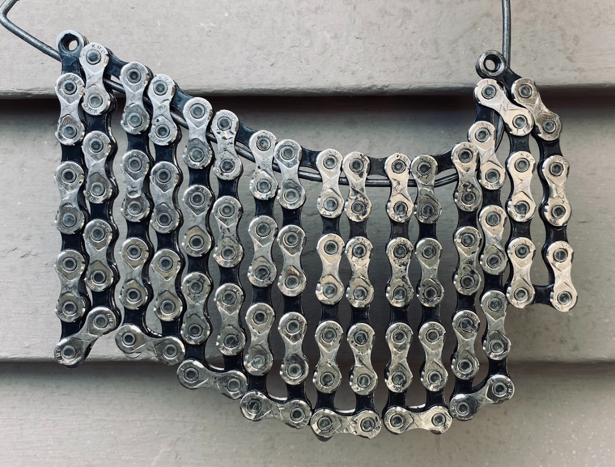

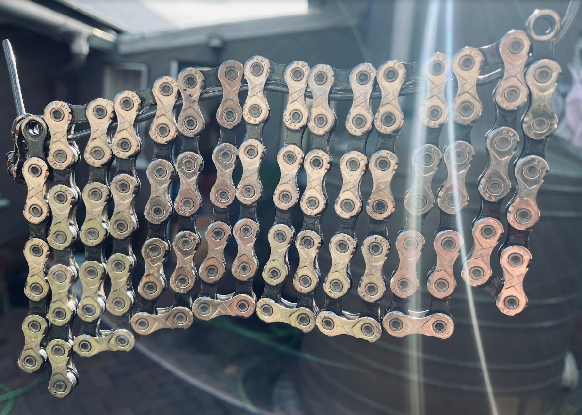

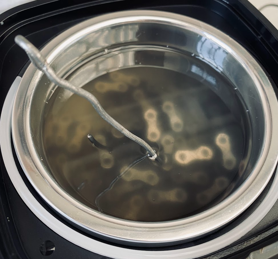

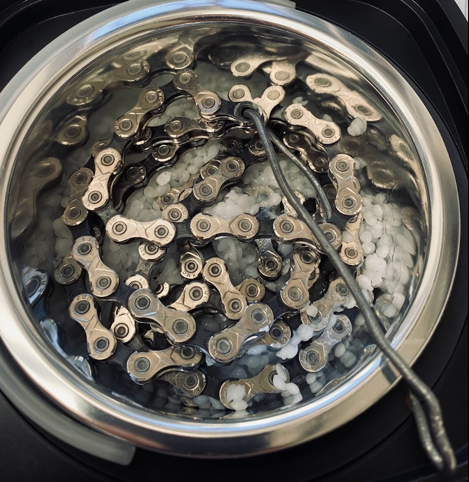

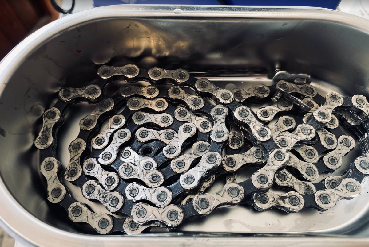

More pics:
Post US:
Into the meths:
Post meths, drying before waxing:
