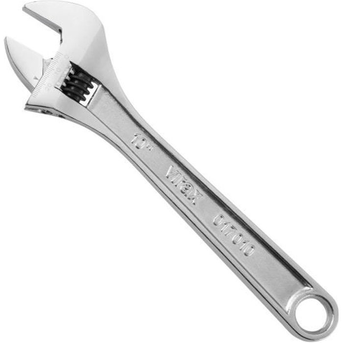

Okay so after that XCO horror I cleaned it all up, took the chain, cassette everything out, and realised my hanger was bent... I bent it back using this really sophisticated tool
Got to admit it works really well now, I can finally experience what high end shifting is supposed to be, you don't have to wait 3 revolutions for your gears to drop it's fantastic :D
