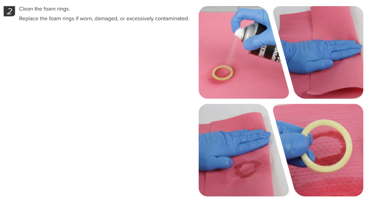

Steady Spin Posted April 3, 2022 Share Thanks. It is a 2020 and I didn’t see a valve to release the pressure. One tool I need to get is a pair of c-clip pliers. I think I should leave this one to a shop to check. Also need new foam rings from the looks of it. This set is deforming a bit and didn’t come clean during the alcohol bath. Link to comment Share on other sites More sharing options...

droo Posted April 4, 2022 Share As for the rest: Don't stick zip ties down your fork seals, for the love of Jehovah. If you have to release pressure from lower legs (unlikely unless you've climbed 3000m in a day), do it via the footnut holes. If your foam rings are dirty, replace your wiper seals. Foam rings there to catch the crap that gets in when the seals can't. When they're dirty, the seals are done. Cleaning them with alcohol will swell them and render them useless. Wayne pudding Mol 1 Link to comment Share on other sites More sharing options...
Steady Spin Posted April 4, 2022 Share Good to know. Thank you. Can they we worn out from about 6 months of use? Was replaced in November and they still look perfect. Noted on the burping with cable ties and use of alcohol. Link to comment Share on other sites More sharing options...
droo Posted April 4, 2022 Share Depends how much you ride. 150 hours and you're done, and that can come up quicker than you think. Worn seals and new seals look the same, except for the grubby foam rings under them, which is one of the reasons foam rings exist. Steady Spin, Trashy and Wayne pudding Mol 1 1 1 Link to comment Share on other sites More sharing options...
