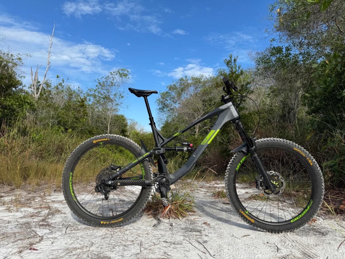

I hear you. Never really liked how this Lyrik felt. Put in a new dampener a while back feels better but still not mad about it.

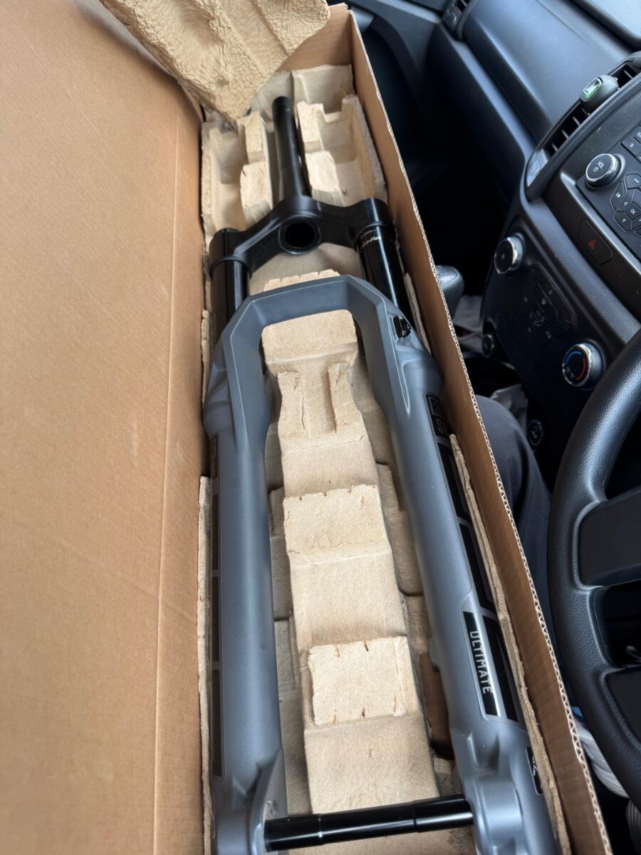

only reason I’m thinking about this Zeb is cause it is literally the only 27.5” fork any bike shop here has and it is half off.
Zeb won't fix that your issues then IMO. the 2.1 will be the same damper, with a different spring to your Lyrik. If it is a Charger 3.0 Zeb, then budget for Physio as they are widely reported as being quite harsh

Didnt pick up on the 27.5….yea then get it before soneone else does lol. Those are as rare locally as that unicorn bike of yours😊
Ja I sometimes wish I went for a 29” option. Finding  things here are difficult enough and not everything ships here either…
It has the 3 with buttercups. Not sure if they help but time will tell.
Found a physio here the other day, I swear I think it might be the only one so I know where to go knocking now.
Thanks for being so reasonable but I have decided to give it a go and see how I get on with it.
