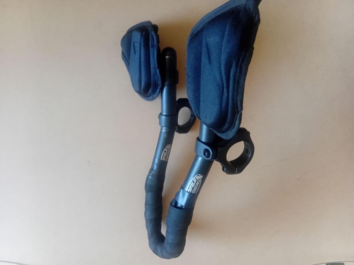

These were the bars i was discussing, (Bike Hub buy & sell…) and am now buying them and will - safely - make them work, with a small engineered adjustment.

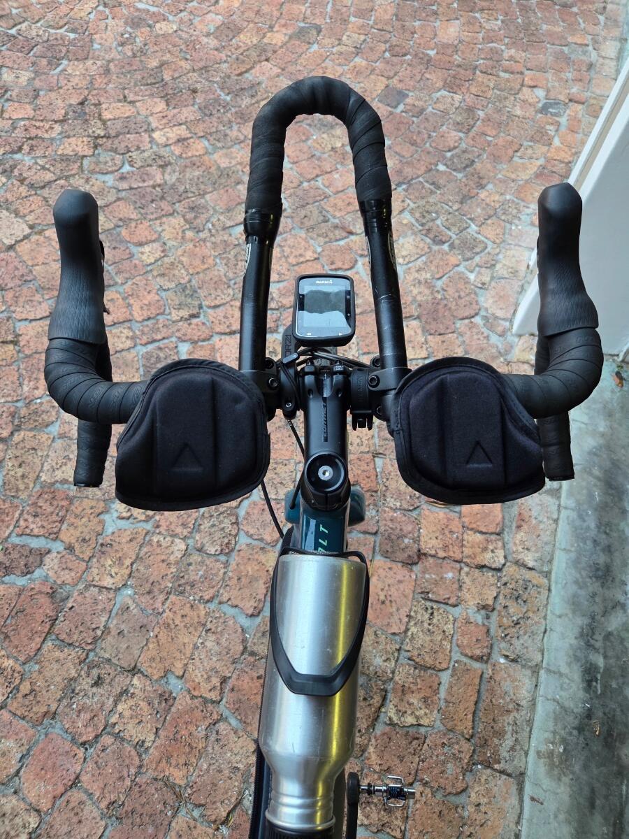

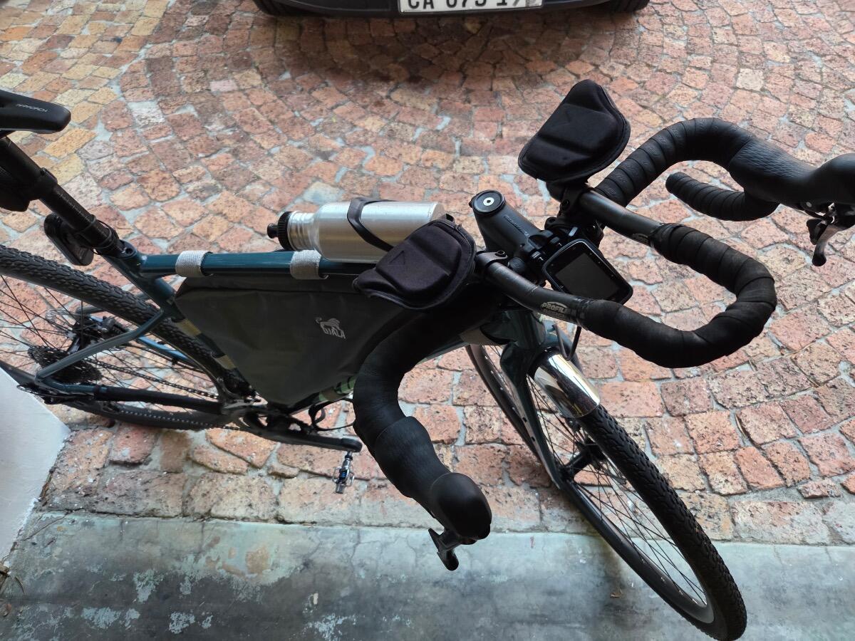

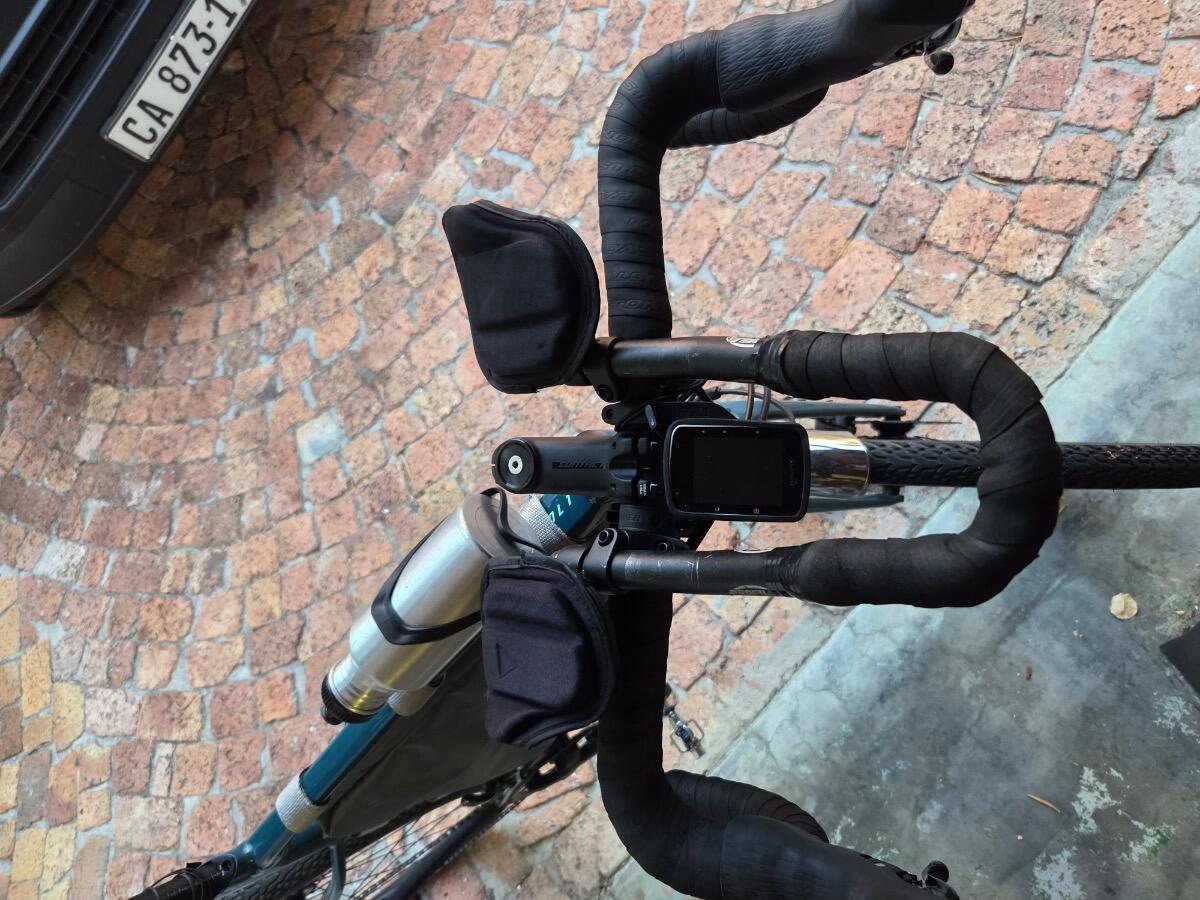

Test fitted the tri-bars on the Revolt last nite, they work fairly well, better than i was expecting, and this weekend will make some adjustments to increase the safety of a round clamp on an (slightly ovalized) bar, and report back here…
