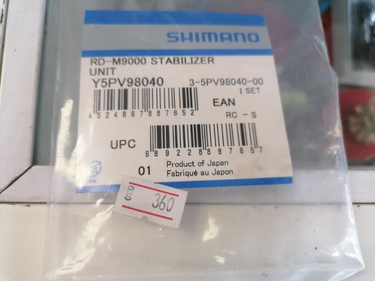

  13. On closer inspection, that doesnt look like rust but rather the previous owner (or you?) used the wrong grease on the clutch system. That brown gunk looks to be coagulated grease on the shaft itself. Im sure with some elbow work you can get it clean again and re-use that P axle and clutch. But dont scrape it off with a sharp blade or with sand paper. That will damage the surface the clutch rides on. Try remove the axle, then soak it in some strong cleaning agents like petrol, acetone, thinners etc to release that old grease Of course, if you have 360 ronts then just buy new and be done with it

  16. Here you go Ruben - DM me and I'll send you the LBS details. They're in Germiston, Johannesburg Replace these parts, give the spring a good clean and you'll be as good as new. And use the correct lube too - any decent light bicycle hub grease... not the junk for car wheel bearings

  18. Remove that cage and give the coil spring on the other side a good once over with cleaning material. I'll be at my LBS tomorrow and check if they have a new clutch kit for the XT - I'm sure they do. Will let you know Doddy does a good tutorial on how to do it all yourself:

  22. It's the same as the 12 speed clutch for deore, slx, XT and xtr Check the smaller lbs, they tend to have a better variety of spares
