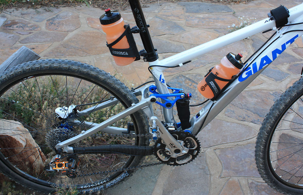

  2. +1 on Anthem. One of the best performing suspension designs out there. It can be set up to feel plush like a long travel trail bike, or can be set up to be a very fast race bike. Plus, if you get a small or XS frame, there no rear shock in the way when taking your water bottle out.
  3. Giant Anthem X0 Size XS RP23 EC 70 bar Ergon R2 Carbon Grips X9 twisters 80mm no name stem Sid Race XT crank SLX front der X0 rear der XT 11-32 XT chain 540 pedals KCNC seatpost SLR 135 saddle Formula RX brakes American Classic tubeless wheels with Rocket Ron tyres 10.6kg - cost me under R28 000 - all parts from eBay, CRC and some local bits...
