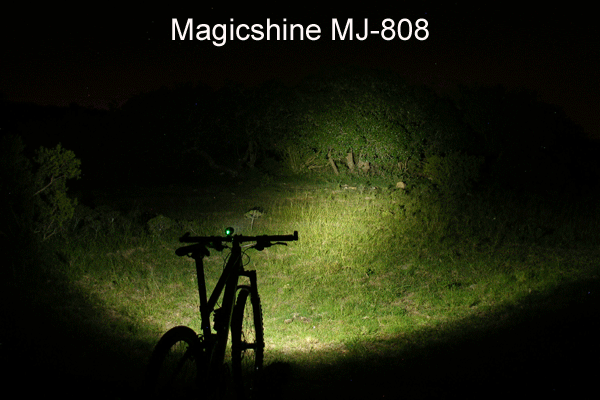

  2. The Revelation-3R has just been launched 2 months ago. No way you coul've used one in Trans Baviaans before. Must be one of the much older ones. The light would've have moved if it was tightened properly. The Revelation-3R is a brand new light that's almost double the brightness of the old one and 220g lighter, with the same burn time... 110g light head unit, 35mm dia... Total light output measured in integrated sphere: 2006-2008: Revelation-3 - 720g, narrow or medium beam : 57 Lux 2008-2009: Solo 620 - 450g : 40 Lux 2010: Revelation 3R - 550g : 90 Lux 2010: Revelation-7 - 600g : 135 Lux Magicshine MJ-808 : 40 Lux SigmaSport Karma : 10 Lux
