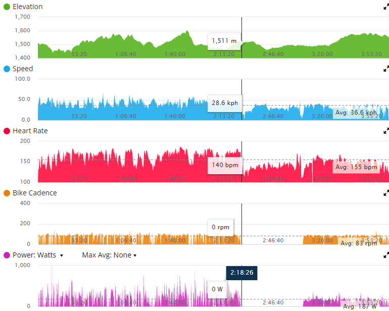

UPDATE:
Still have a issue.
Big up to the guys at navworld.
The unit was fully swapped out for a brand new sealed box edge 520 unit without any hassle at all.
unfortunately the issue of dropped data remains. even with the new unit, new HR strap, new batteries in my P1 power pedals.
the unit once again disconnected all ANT+ sensors and my Phone (bluetooth), then a minute or so later reconnected everything.
i can only assume its a software programming glitch?
i will keep one eye on the unit and try see if there is any external factor i can find.
not a big issue, but if this happens 18min into a 20min FTP test... that might be a bit frustrating.

Just to post back on this topic.
today while Zwifting (ie indoor training) i had my power, speed, heart rate and bluetooth all drop then come back online a minute or so later.
pretty much means its definitely a software issue.
frustrating that this problem is still around
