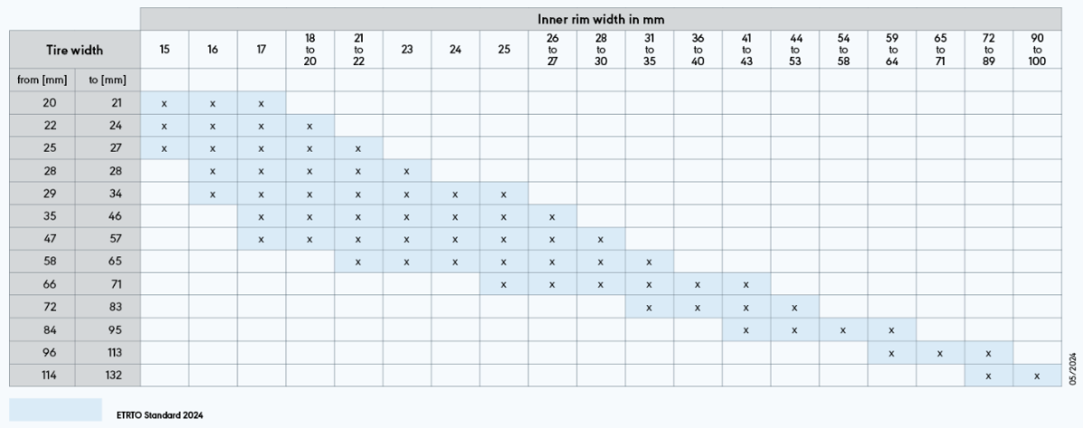

There are a few things to consider:
1. Older road frames had a limit on tyre width for frame clearance, so the internal rim width was limited too. As new road frames change to accommodate wider frames, so too are rim widths getting wider.
2. If you put a wider tyre on a narrower rim, it will result in a tyre that bulges/balloons, and likewise, with a narrower tyre on a wider rim.

My TCX has 700x40C tyres (haven't changedsince buying about a year ago (2017 model). It has enough clearance (pre-mud) to fit 42c. The rim shows 622-19 (SX2), so the question would be "what the optimal tyre width and pressure be, relative the rim width". The sidewall shows min 2.0-3.5 bar, so I go about mid-point (non-tubeless setup). Shows how serious I am about riding gravel 😁
