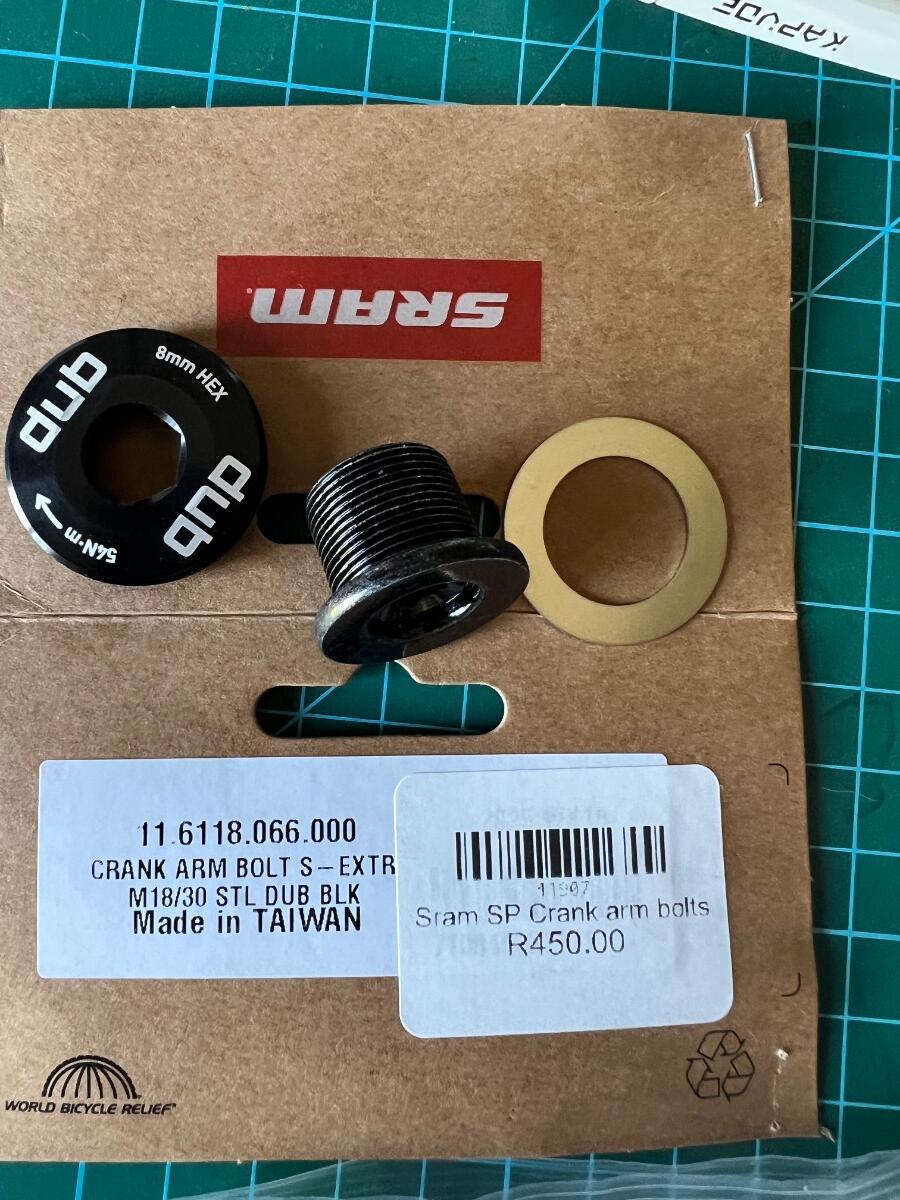

We have removed plenty of those bolts.
So the offer stands. Bring the bike and we will remove it and fit the replacement for you.
preferably a steel one👍

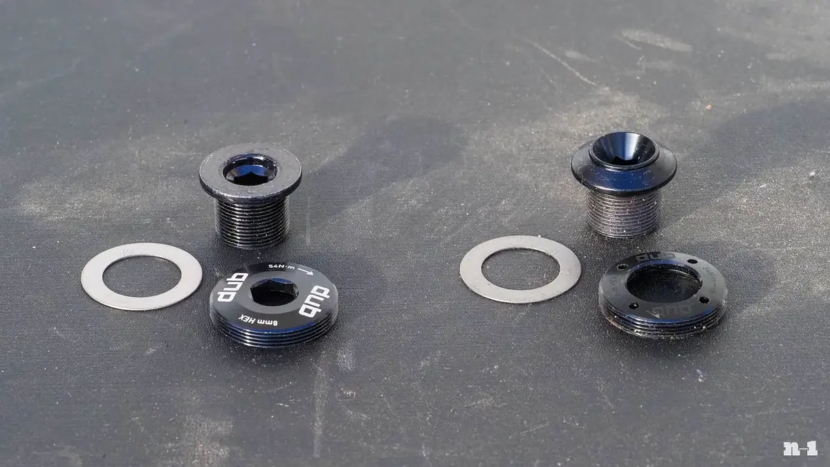

the assembly at left is 13 g heavier than the aluminum one at right owing to the former’s steel bolt, but it also works much better.
https://nminus1bikes.substack.com/p/stop-skinning-your-knuckles-on-crazy
