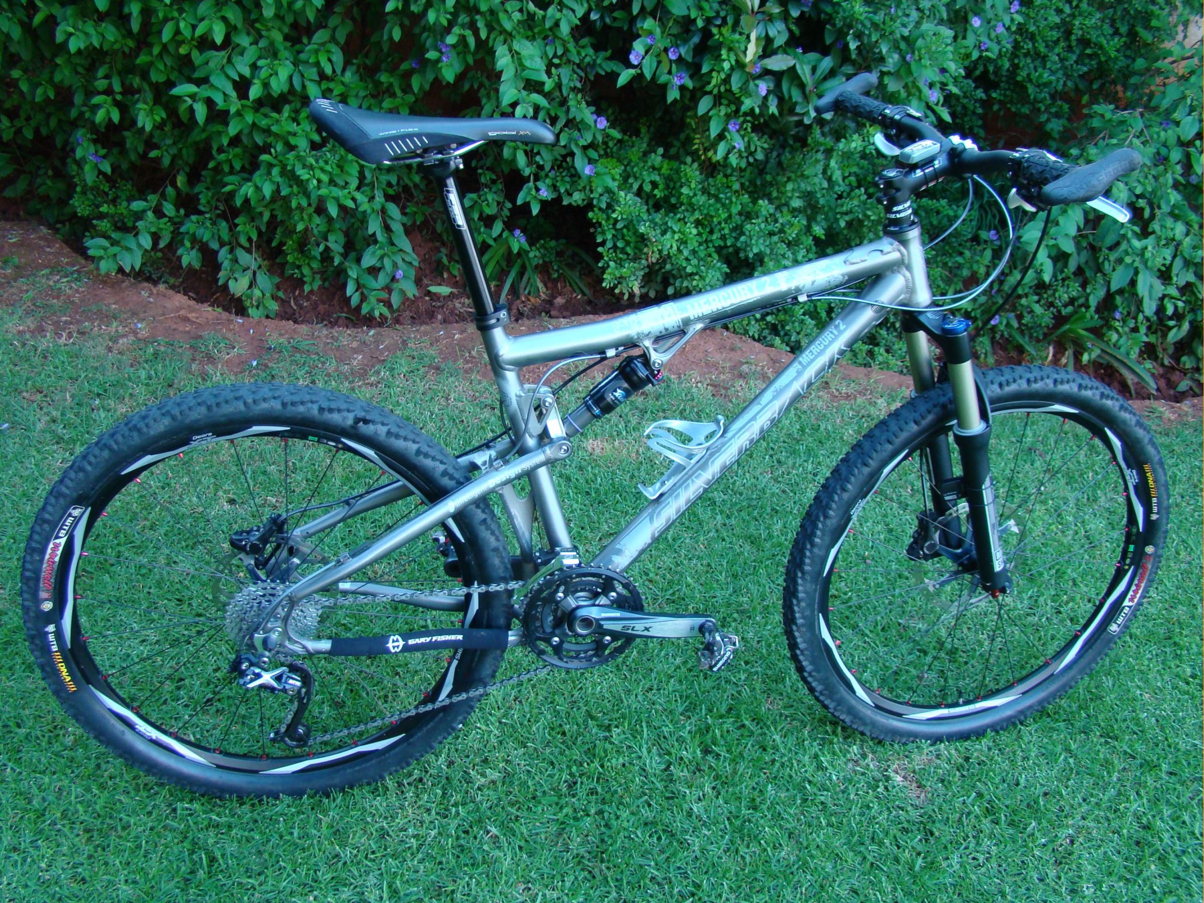

  1. My bullet proof Mercury 2

  10. Good bike and good value for money thats the 2009 in your pic. 2010 they called it merc 1 and gave it an XT crankset and the old merc 1 became the XTR. Judging by the amount of people riding Silverbacks at most races I would say they are pretty popular and lots of people buying their lower spec models as there first bike to get into the sport. Maybe I am biased because I ride one

  13. Been riding a mercury for the last 14 months great bike no problems If you want good spec and value for money I dont think you could beat the mercury 1 for 16500 plus Silverback give great aftersales service.
