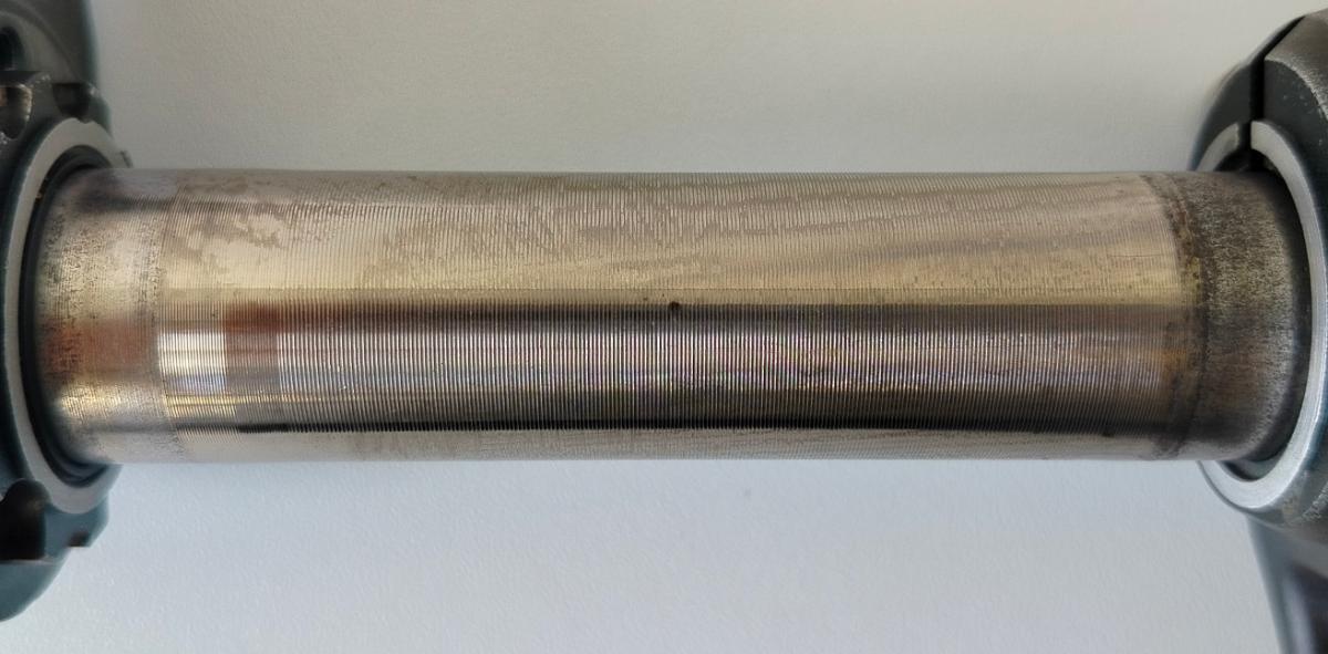

I'm struggling with a stuck pressfit bb. Tried hammering to no avail.Ā Would a bearing puller tool work?
My concern is that there isn't enough exposed bb shell around it for the cup to hold onto, if that makes sense.

Press fit BBs........eish.
That is when I rely on my local bike shop.

Probably the best and easiest option. It doesn't look too difficult if you have the correct tools, but I'd still prefer threaded.Ā At least I got the drive side one out now. Left not budging, yet.
Install doesn't look too difficult. I'll probably get some threaded rod, nuts and washers to make a press. Depending on how well that works I might buy more proper tools.

I'd guess your problem is that the frame isn't supported close enough to the BB for you to be able to get enough shock through the interface to knock it out. Ideally a block of wood with a hole in it the size of the OD of the BB would work to support the frame so you can get a proper whack in, but that's a very specific size of bit you'd need to make it. Making 2 V blocks might be easier to do but more difficult to manage on your own.
That extractor should do the job if you're up for buying tools, but for a quick and dirty fix you can knock the bearing out of the shell which should remove enough of the preload to get the shell out. afterwards. To get the bearing out, lay the shell flat on a block of wood for support - no need for anything special, you'll be able to move it enough just on a flat surface to get it loose, then back in the stand for the last bit.

Any tips for installation? Would a diy solution work? I suppose the most important part would be to get the bb in straight and have a washer that covers the entire area.

"A DIY solution" is a very broad spectrum, I haven't seen what you're capable of... no offence meant, but I've seen some questionable work in my time.
But yes, getting it in straight is the most important bit. And the easiest thing to break in the process is the sleeve between the two cups, which will go out of alignment if a mouse farts in the next room.
This is one of those jobs that I'd say either get the tool or get the LBS to do it for you. Unless you have a carpenter's bench vise, which is about the only non-standard tool I can think of with big enough parallel jaws to get the job done.

Thanks.Ā I'll need to think about whether I'm going to try to install a new one myself.
After getting the RH one out I managed to get the left one out using a pvc pipe which was just the right size for the job.Ā It might be stuck in the pipe nowĀ šŸ˜…
Is there a significant difference between the MT500 and MT800 /Ā SMBB7141 ones? Is it worth the extra cost? I might not have much of a choice as the lbs doesn't have the cheaper one. And I'm not 100% sure which the correct one is.
