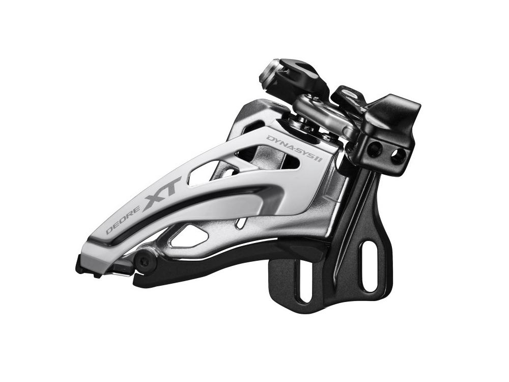

4 hours ago, Prince Albert Cycles said:
I need to fit a side swing direct mount front derailleur on a pre Ocho Scalpel . Shimano 2 x 11 group.
The frame has 2 horizontal fixing points on the seatpost, one a bit recessed.
Which of the zillion fd’s out there will work …and where to get.
thanks
On the seatpost? The scalpel 29er and Sclapel Si both fit the type shown in Droo’s post. The last scalpel to fit the front derailleur to the seat tube was the 2012 scalpel which was a 26er.
the 29er scalpel had the fd mount integrated onto the lower pivot.
which scalpel is it?

22 hours ago, Prince Albert Cycles said:
My mistake . Fd mount not on seatpost but on lower pivot mount . Bought the frame and fork as 2018 model but saw later that 2018 Scalpel came with Ocho fork and this had the pre Ocho fork so I suppose it is a 2017 .
ok so it s a Scalpel Si which has the FD mount on the chainstay. The 2017, 2018 and 2019 models were fitted with Lefty 2.0 XLR OR Lefty 2.0 PBR. I'd actually advice against mounting a front derailleur on this model frame. The FD actually swings up and down as the suspension moves and makes reliable front shifting a bit ....interesting. It was a bike they intended to launch without FD capability then hacked a mount late in the design phase.
Eisch..should have been aware of this before my parts spending but thanks
