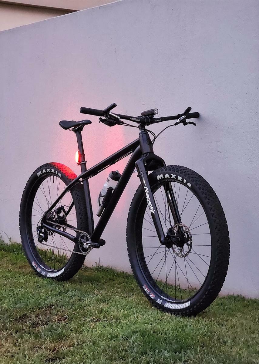

Flat bar rigid MTBs with gravel tyres are a fracking hoot. Gooi some cheapo bar ends in-board of the grips and you've got a relatively aero position too. My current rig:
(this is getting skinnier wheels and rubber soon, so don't think I'm proposing a 3" tyre as a "gravel" mtb)
