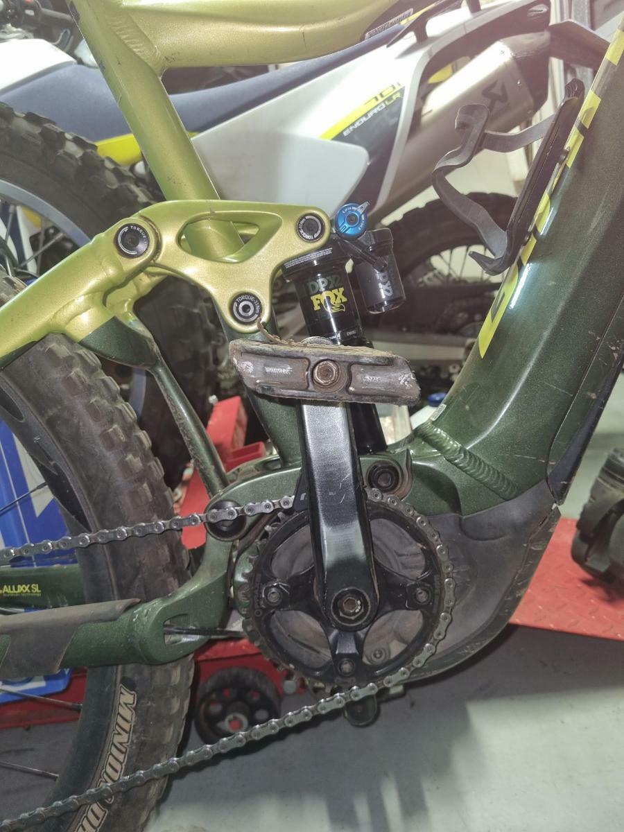

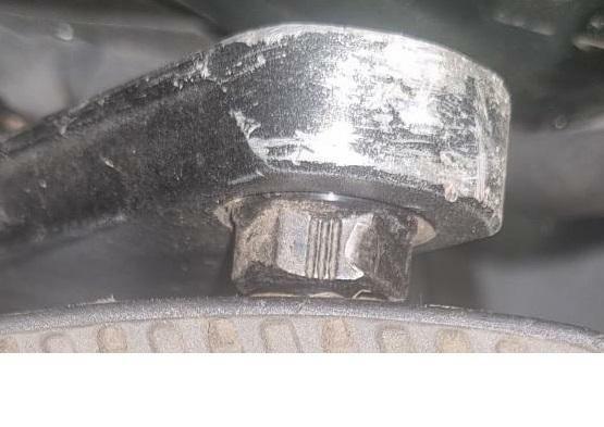

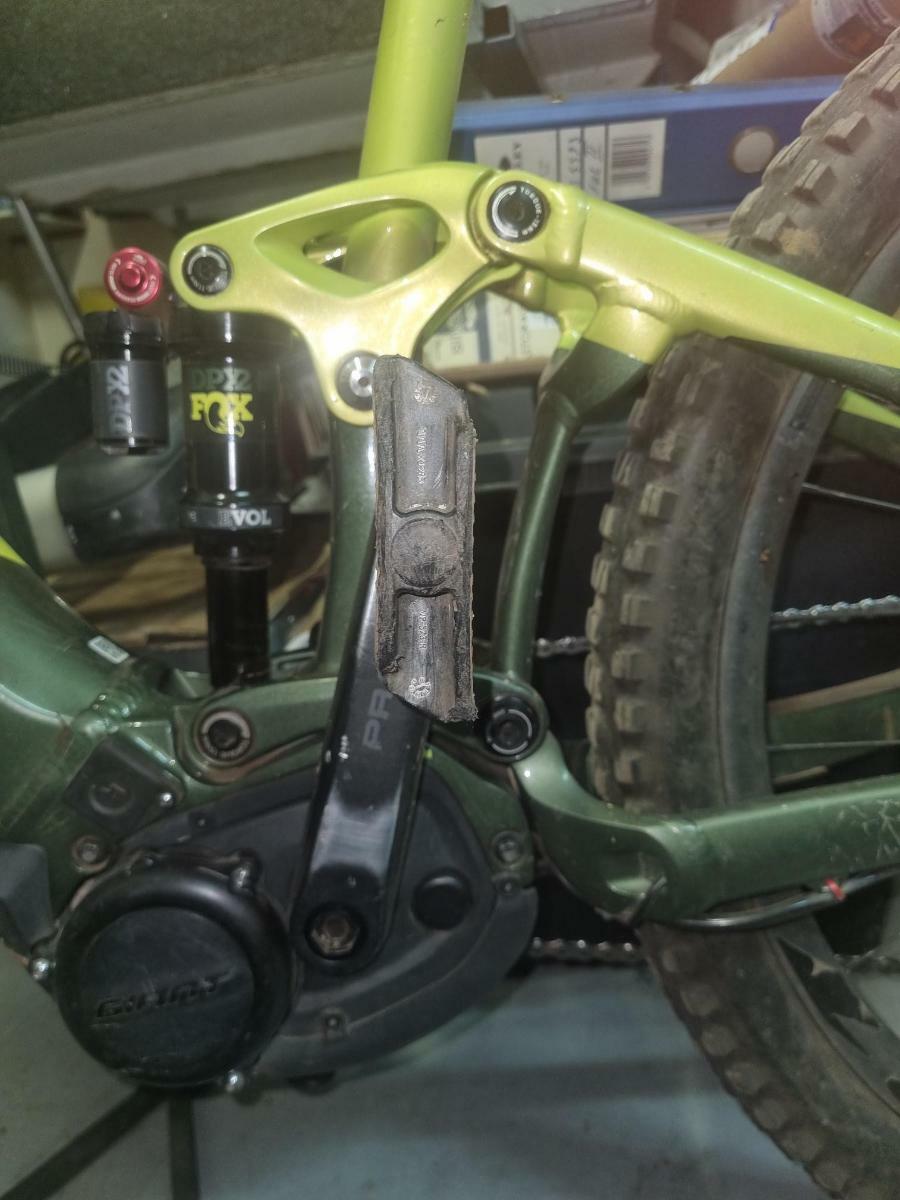

Apologies; riding, family catch ups and work interfered.  Thanks for the comments and a few things to try. This is the RHS pedal where the "L" can be seen if zoomed in.
Below it is the LHS one, its hex and the "R" can be seen if zoomed in.
I am a worried man.🙈
RHS hex zoomed inRHS pedal
LHS hexLHS pedal
If you can get the pedals out and the threads aren't damaged then the cranks are definitely on backwards, which makes sense since there was work done on the motor.
There might be markings on the back of the cranks that tell you which side they should be on.
