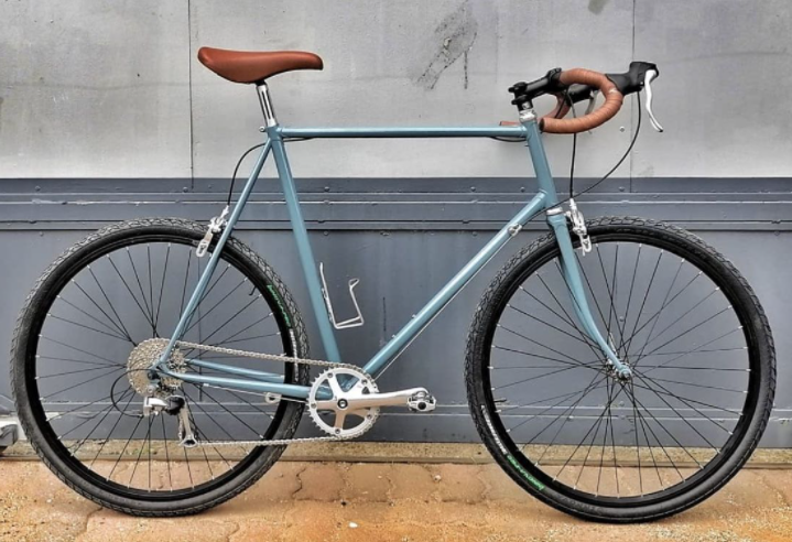

Venturing into unknown territory here, so I need some guidance from Hubland.
I'm keen on restomodding a vintage road bike into an allroad / gravel machine. Planning on doing some restoring, some painting, but mostly just to have something to fiddle with in the garage. Keen on doing it on a vintage bike because steel most definitely is real, I can pick a project bike up for relatively little money, and they're just cool looking.
Keep in mind:
  • I'm doing this to have fun, so trying to keep the faff and cost level to a minimum (i.e. not too keen on buying a R500 tool to extract some exotic bottom bracket). So being able to fit a relatively modern brakes or groupset, to simplify finding relatively modern parts, would be ideal.
  • I want something as "consumer" as possible. Partly because I don't feel like defacing some mythical bike with my ham-fisted workmanship, and partly because its likely to be cheap.
My ideal donor bike, and what I plan on doing:
  • Capable of taking a MTB / gravel drivetrain (i.e. 1x 40t-ish chainring, maybe an 11/32 or 11/42 at the back) or being set up single speed. So something with a freehub and not a freewheel.
  • Frame will be repainted in olive / miltary fatigue green. All hardware gloss or matte black (little to no chrome).
  • Can take some 30-33mm cx tyres (highly unlikely I know).
Idea is that I take a bike that's pretty much running at the moment, disassemble it and restore the existing parts a bit to neaten it up, then slowly change it to get to my vision.
What I need some help with is which bikes I should look out for, what I need to stay away from or be aware of, or even if there is one for sale pointing me in its direction.
I'm considering this bike (I rode a 56cm Titan Switch with a 70mm stem which was a bang-on fit for me, so I'm thinking it'd fit me at least): https://bikehub.co.za/classifieds/item/vintage-bikes/533345/classic-zini-with-shimano-105s
Think this, but more Judas Priest and less Mumford and Sons:
Edited by TyronLab
Link to comment
Share on other sites
You can use a multitude of old SA built frames but make sure to look for something that can handle that size tire. Many of the frames built from Reynolds 531 tubing and up have tighter geometries and therefore can't handle tires above 25C... maybe a 28C if you're lucky. Clearance on the brake calipers is also something to look out for.
Cheaper frames with more touring type geometries work a lot better and are also better suited to gravel riding.
I'm about to start on a similar project with and old Alpina frame.
Link to comment
Hennie's is very similar to the one above done by Whippet. He's got a 1x9 drivetrain on it 30C cyclocross tires and his clearance on the caliper is "balhaar". He actually took a few mm's off the caliper with a dremel to get the tire in.
