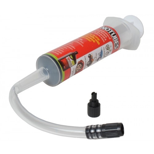

It was to much of a headache though, so I got on of these Stans syringes and it's the easiest. Just unscrew the valve internals, screw on the supplied nozzle, pump your sealant in and re-inflate, easy job.
