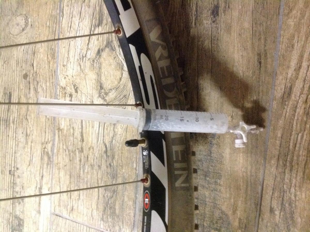

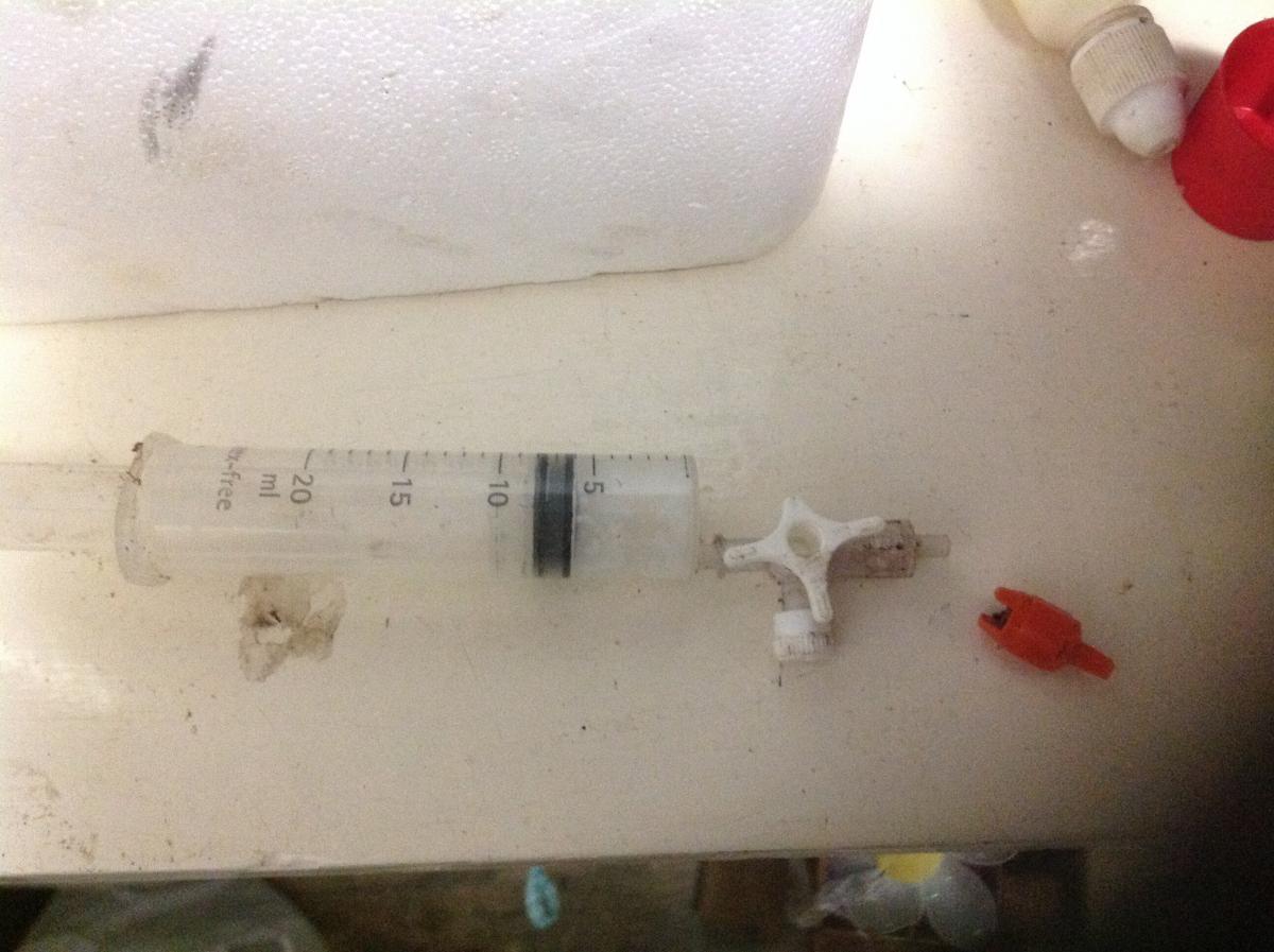

I get these from theatre .Works like a charm .20ml syringe with T stop valve .Remove core ,deflate to just before tyre comes of rim .Add stans and screw in core again .Note ! Don,t use valve cap .It sticks to core and tends to screw out the core when you want to remove cap .Not good ! 10minutes before a roacepost-26961-0-17272400-1431108521_thumb.jpgpost-26961-0-09916600-1431108561_thumb.jpg
