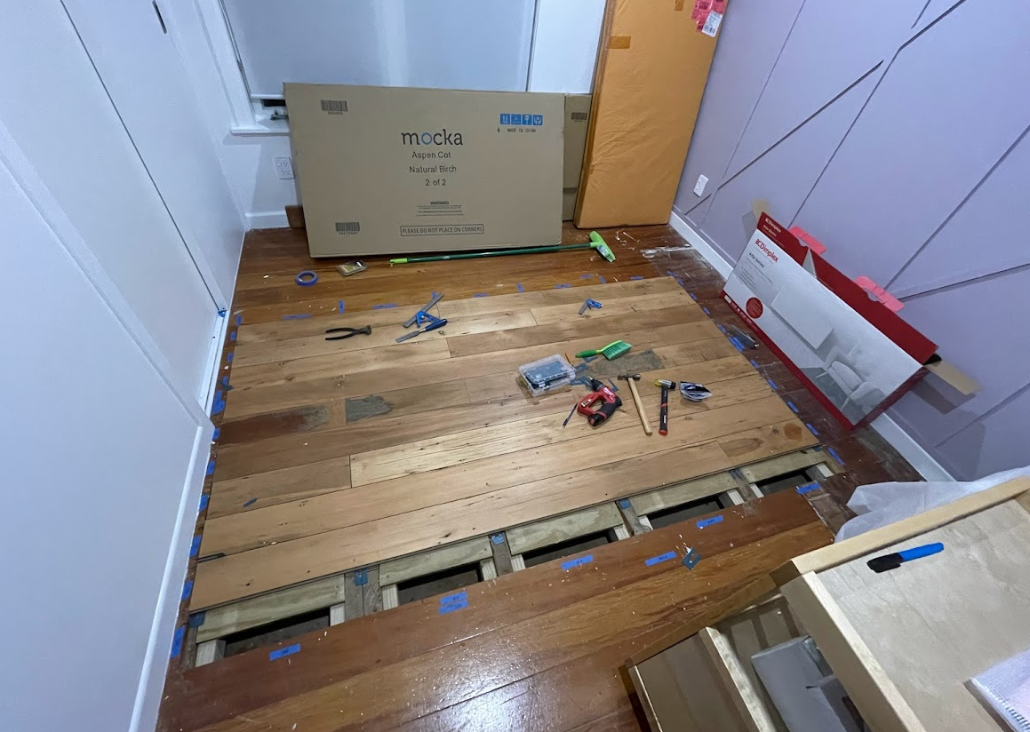

This weekend it was high time I checked something off my to-do list.
When we renovated the kitchen and laundry, I removed a wall which left some unsightly gaps in the 70yr old, native hardwood flooring.
Various excises like "I can't find the right lumber" or "the timber yards are only open on weekdays while I'm at work" had me procrastinating this for nearly 3 years.
So after taking a day off work to visit some timber yards (and hardware stores), watching a Scott Brown video or 2, I procured about 5m of Rimu tongue & groove floorboard and got stuck in.
First was removing the damaged boards as carefully as possible so as not to damage the adjacent boards
Being able to plunge (with either the track saw or oscillating multi-tool was instrumental to this.
Next was to re-mill the new boards so that the groove aligned with the existing tongues.
Thank you slot cutting router bit which scared the crap outta me! I was checking the arbour nut every pass to ensure I wasn't creating a spinning ninja-star of death.
Turned out ok though!
Then, as the filler/last piece of floorboard had to be custom sized and needed the tongue removed (to allow installation), I added some 2x4" supporting pieces to reduce flex.
Once I ripped the filler piece down to width, I added the grove with the table saw (felt safer than the router), and chamfered the tongue side bottom edge to allow the strip to be taped into place.
Pre-dripped the nails holes to prevent splitting, hand nailed the boards down, wood filled, sanded to 240 grit and a few coats of poly urethane... done!
Not a perfect match for the existing boards, but same species and better than the gaping holes.
Edited by patches

When I ripped up the carpet in this room, I expected to find lovely native hardwood (Rimu) flooring, but to my horror I would a sheet of chip board (approx 2.4m x 1.2m) filling a void.
(Aforementioned decorative wall shown in background. Ignore the idea cabinet, this photo was used when I was getting rid of it).
So the challenge... New Zealand native Rimu is protected and using reclaimed timber is the only viable option to obtain some (unless one settles for Fijian Rimu).
Reclaimed and re-milled Rimu can fetch prices of up to R440 equiv. per linear metre (of 135mm x 19mm tongue and groove). I need about 30 linear metres.
So being the cheapskate that I am, I found a pile for sale, fresh from the renovation of a 100yr old villa. Approx. 130m worth of 140mm x 21mm T&G. So I bought it site unseen for about R7400 equiv. and ended up with this...
The wife come with me to collect it and looked at me like I had just sold the family cow for a handful of magic beans.
After a day of physical labour, scrubbing, hauling, and sorting (and numerous graunched knuckles), I found the best pieces to be stacked and stickered under the patio table
I then took a sample piece and ran it through the planer and the magic beans are starting to look promising
Still a looong way to go, milling, trimming and routing, but hopefully in the end it'll all be worth it.
...if not, I'll just buy a big rug to throw over it 😅

Sent the wife this picture while she was out shopping yesterday...
She was a little alarmed! Note the 7 decades of junk that previous owners have just stashed under the house 🤢
Fortunately (for me) I had a new sub-floor installed by the end of the day. The sub flood was not needed (structurally), but I figured I may as well beef things up and make it safer while I'm still milling the reclaimed floorboards

that first pic reminds me of my sisters place that they bought. Previous owner was a bit of an eccentric engineer type. Was obsessed with being 100% off grid.
On the property was a separate house to be used as a guest/granny flat. double story effort situated right next to his storm water catchment pond.
The wooden floor boards on the lower level felt a little bouncy, so during renovations of the main house they had the guys lift the floor boards to see what needs to be done. Turns out this dwelling is sitting ontop of what can only be described as a swimming pool. A large excavation, completely marbelited like a pool. Closer inspection of what it actually is meant to be revealed that it was an over flow for the storm water pond, allowing storage of an additional 30k litres of water.
With the mother-in-law fast aproaching from Aus this week, and me having to oversee a shutdown on site this past weekend, I started feeling the pressure to get the nursery floor done. So  took yesterday (Monday) off work to make noise and sawdust, and got most of the boards fitted. Just the last row left, which will need to be custom sized to make up the gaps.
So much milling, drilling, routing and spacing 😓
I'm also in 2 minds as to whether I hire a floor sanding machine to get colour consistency, or if I just rely on the larger 3m x 2.4m version of this rug to cover up the patch, and refinish the floor when we do the rest of the house.
