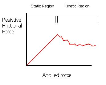

Hmmm, I beg to differ that max braking force is at full lock. At full lock the brake force is a function of the dynamic friction coefficient between the tire and road, as the two surfaces are moving relative to one another. When not at full lock the static friction coefficient is at play as the two surface are not moving relative to one another. The static friction coefficient is always higher than the dynamic friction coefficient. This is why it is more difficult to get an object moving when pushing it over a surface than to keep it moving.
https://encrypted-tbn2.gstatic.com/images?q=tbn:ANd9GcSo0ENB2NUMGjvoA5hzw9hfvUxzcV9BiVyrAEq0ITTvciOKlKeW
