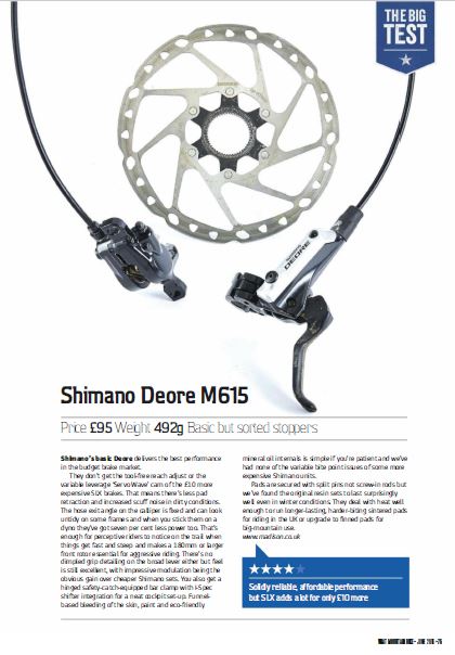

The Deore are basically the SLx without the adjust dial.... you need a #3 allen key to do the reach adjust.
SLX are probably the bees knees.... Formula are really good too, but I do know they used to use DOT fluid, where as all Shimano brakes use a very friendly, way less corrosive mineral oil.
The above comments pretty much sum it up. Buy Shimano.
I run a set of Shimano's on all 3 of my mountain bikes
I went from Avids to Shimano deore on both my bikes, and XT and Alivio on my wife's bikes.
They are simple to work on, pads are readily available and just work. The deore 615 actually have a decent amount of modulation as well (something shimano used to lack.)

Those Deore brakes seem quite nice, I think they could be a winner with 203mm rotors
I run mine with 180s they are da bomb for their price range and easy to bleed etc

The 615s are damn fine brakes for the money, but not quite 1 finger like the XTs. The new slx brakes look great.
