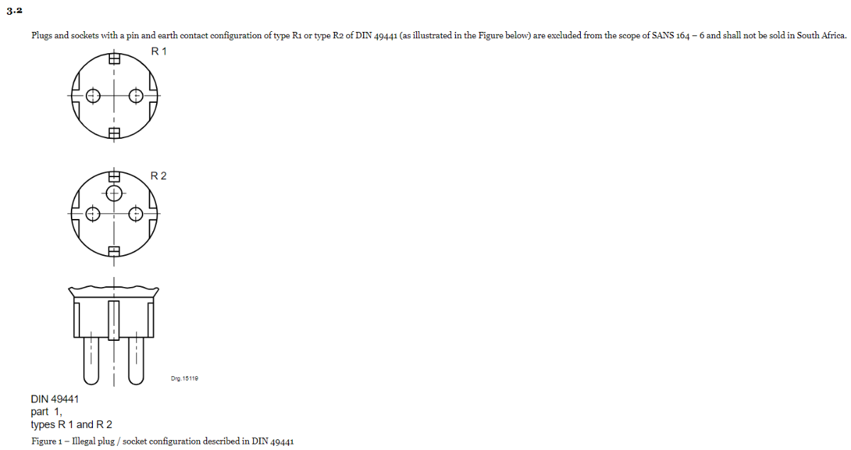

I'm surprised that this plug passed the NRCS inspection, although the plug is compatible in SA.
For those that don't know, the below socket is used in Europe (Germany, Austria, the Netherlands, Sweden, Finland, Norway, Portugal, Spain and Eastern Europe).

Not sure how the importers/distributers got this approved by the NRCS, if it was approved. The standard clearly states that the plug shall not be sold in SA (this is 2010). The first-gen Kickr would have had been made after this date (2012).
My company imports products with a plug, and we had to change the standard Schuko plug on devices, that are sold in certain European countries, to the 3-pin plug we all know well in SA. The kettle/PC plug is simple enough to source for a manufacturer and the only thing that need to change to make it compliant.

That is not a good idea because the plug needs an earth - the metal bits on the side. The bottom picture is the proper socket for it.
I’m aware of that, and I’m also aware that the Kickr’s plug in question is illegal in SA (for that very reason).
