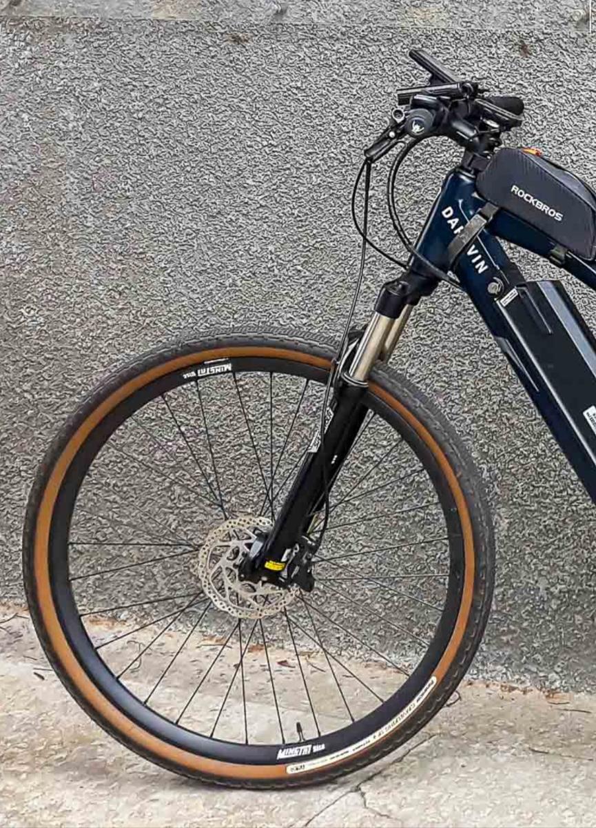

50's fit fine.....

I also run the 700C50 on my HT.
It is a LOT better on tar than MTB tyres.
It feels good on gravel, though I do minimal gravel.
I can not comment on its handling on sand.
After the 2023 Argus I CAN say that it has brilliant grip in the rain ... 😋
I run these tubeless.  One extra layer of rim tape and the tires seated easily 👍
