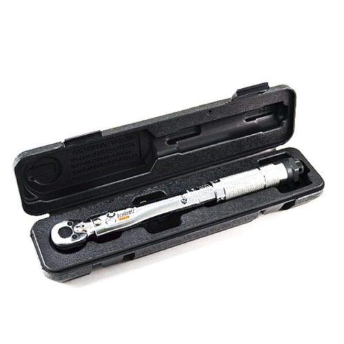

Take a park stand, there’s park tool extremely expensive vs R300 cheapie, if used and stored correctly, it will last a lifetime. I’ve had mine for nearly four your, built multiple bikes, use it all the time and it still looks brand new. If you develop a passion for something, you’ll automatically upgrade without informing the government. Attached is my first torque and my current wrench. Honestly, I’ve never had an issue with the first 1, it’s all about being ballpark.
For anyone interested, the orange one is called the Ocarina (looks like the musical instrument - random fact of the day) and gets good reviews ito accuracy. The drawback is that it only goes up to 10, but I like the type / design. The newer model also has an easier to read gauge.

I’ve got the bottom one. Does what I need, but I’ve got nothing to compare it to
Add to this that few people actually know how to use a torque wrench, nor how to store it between projects ....
Set to the required torques setting ..... GENTLY tighten until you hear the click - STOP !!!! I have seen people turn right past that click, and continue turning until the bolt snapped .... totally oblivious of what the "click" was for ....
When done with your project, UNDO the tension on the wrench setting ....

Using a torque wrench properly, ie setting the torque value, using it, unwinding to pack away .... this becomes a shlep for the small jobs.  So I LOVE the little T-wrenches.  Even better, once at the set value it ratchets, so no chance of over tightening.  The one is 5N.m, and the other 6N.m, the most common values on a bike, so these are used most of the time.
It is so easy and fool proof, that anybody can use it ....
