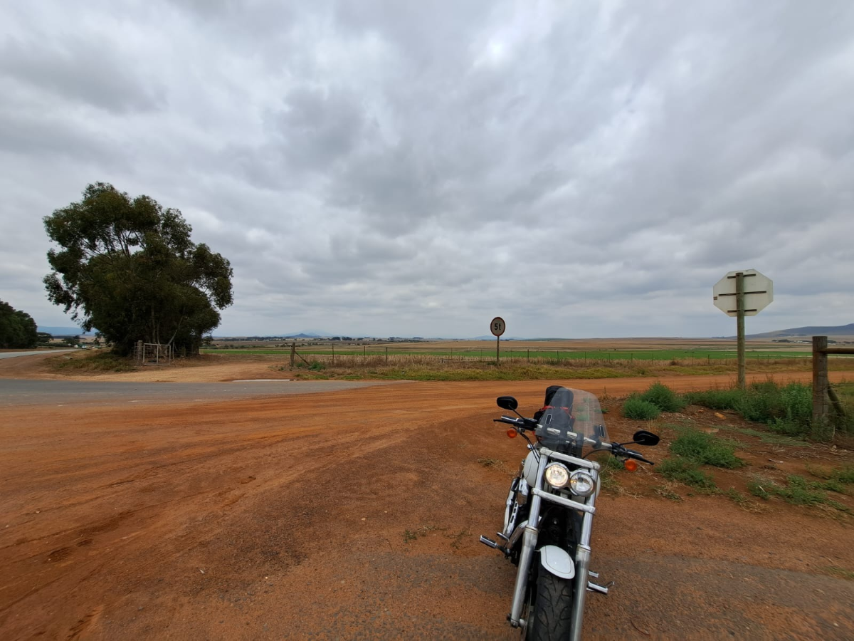

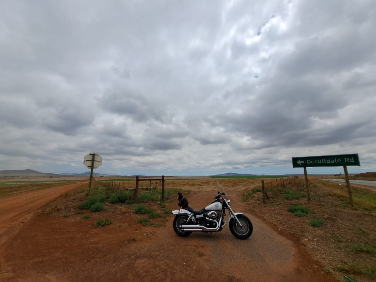

Pics below was a little stop along the way.

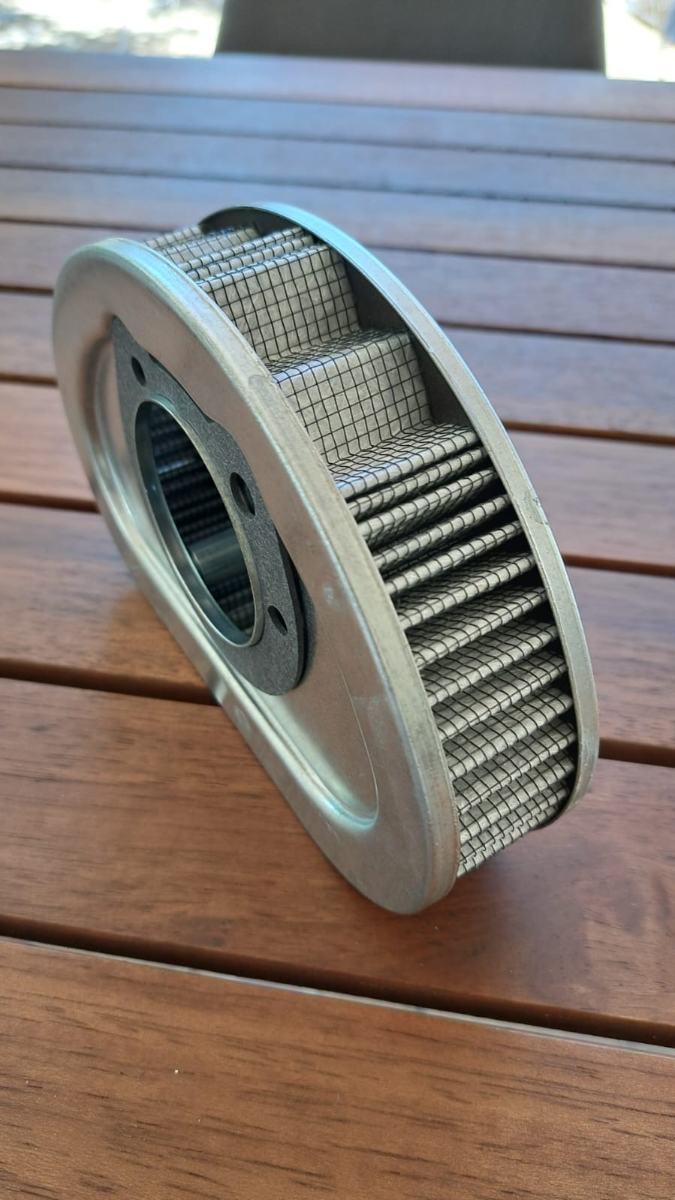

2. would use the HD oils and gaskets I had to do the 3 hole oil service and replace the oil filter
3. I replaced the air filter about 3 weeks ago, he would still get in and clean out the throttle body

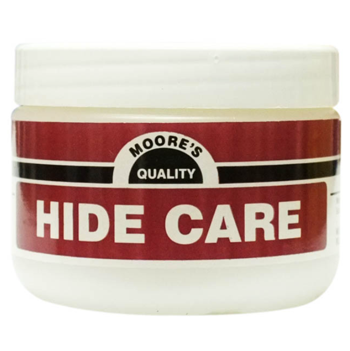

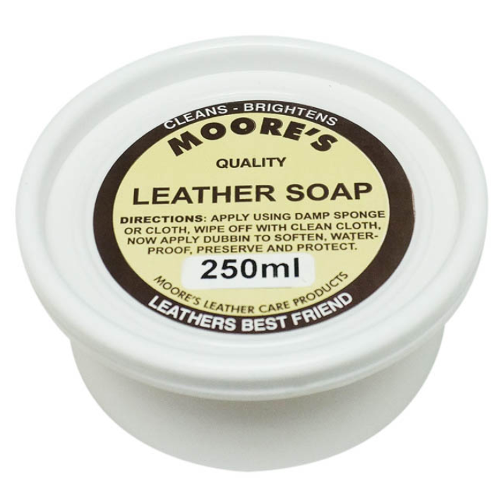

Bought Moore's saddle soap https://westernshoppe.com/product/moores-leather-soap-250ml/ and Moore's Hide Care https://westernshoppe.com/product/moores-hide-care-250ml/ for under R100.00.
Saddle soap with a firm paint brush and a dab of water cleaned all the grime off the leather rather well, I also cleaned inside the jacket by the armpit area "just because". Let this air dry.
Followed up with the hide care, rubbed in by hand and once done, a wipe down with a micro fiber cloth should there be any residual cream.
End result is an excellent finish, and nice and supple leather jacket that looks great, and the hide care cream smells really nice too.
