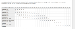

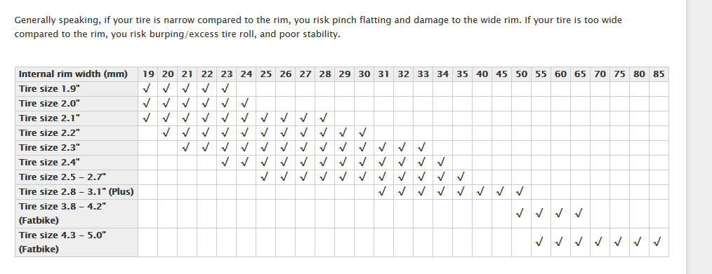

There was an article I read not so long ago (can't find it now of course) where the tyre and rim manufacturers have release guidelines as to the best rim/tyre combos and how running a wide tyre on a narrow rim can open yourself up to a world of trouble as this can cause the tyre to roll/burp and you would have to run such combo at a higher pressure to prevent it thus negating the benefits of the design...
