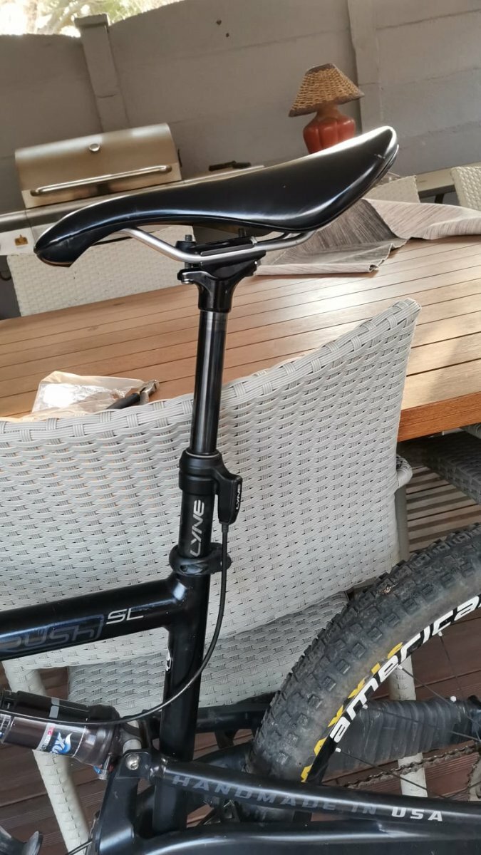

Rolf Hansen Posted August 16, 2021 Share Got my Lyne dropper from David on Friday and fitted it before Saturday's ride at Avianto. I will be using the original front derailleur cable routing for it but for now I just cable-tied it to the shock mount to test it out. Not too much opportunity to use it on this particular trail but the one place I did it seemed to do the trick albeit feeling a little strange because it felt like my seat was missing. Patensie, Bomberman and Jewbacca 3 Link to comment Share on other sites More sharing options...
Alouette3 Posted August 16, 2021 Share NIce! Will take a couple ride to get used to it, or even remember that it is there. Up for climbs, Down for descents and drop it just an inch for those twisty single tracks. Rolf Hansen and ChrisF 2 Link to comment Share on other sites More sharing options...

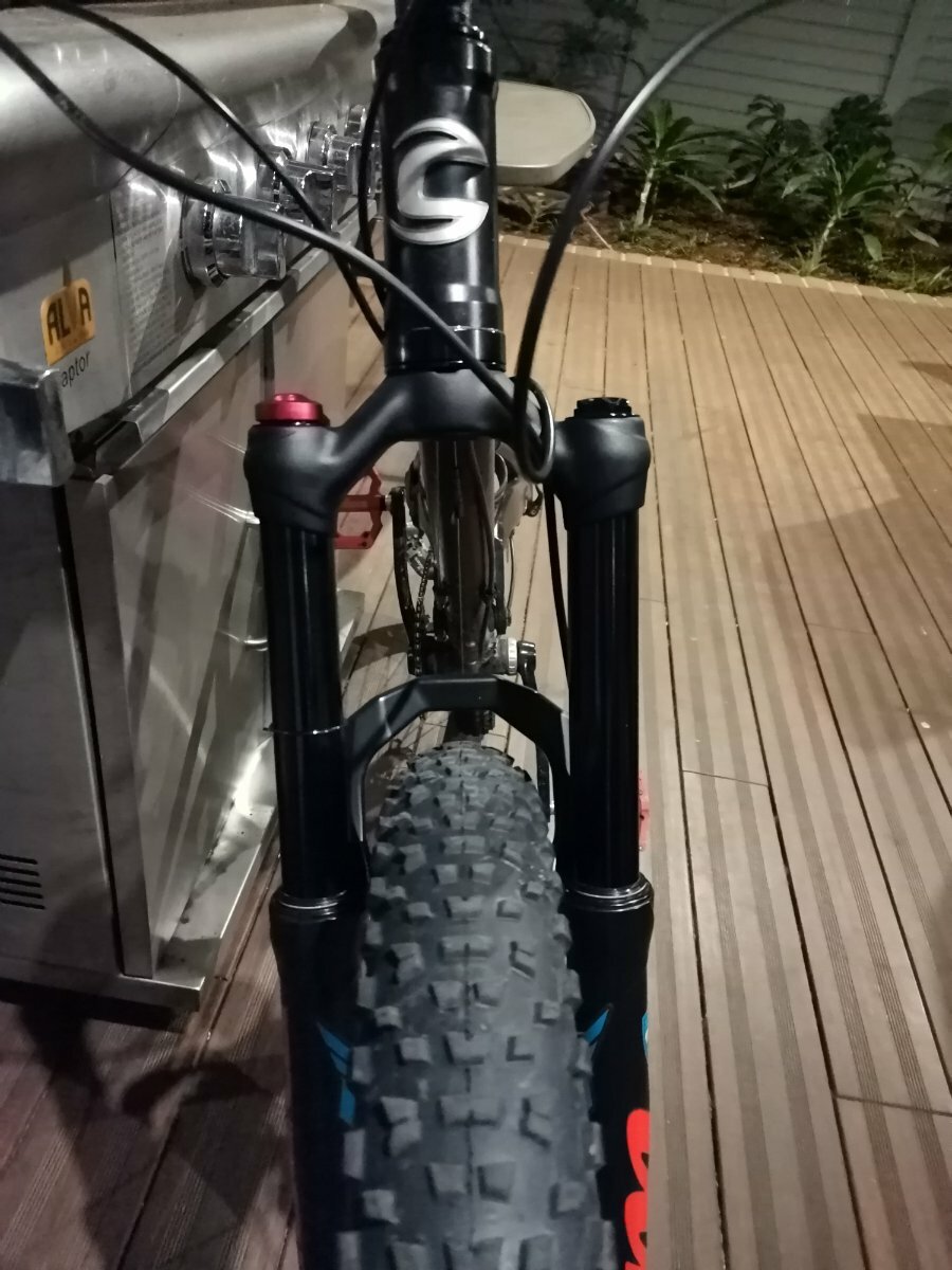

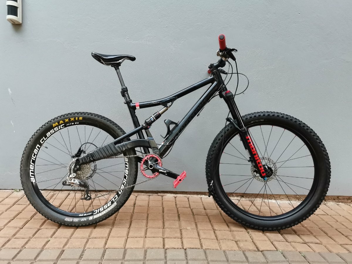

Rolf Hansen Posted October 19, 2021 Share Here she is now. New SRAM Level T brakes with 4 piston upfront and new Rapidé 180mm rotors front and back. New Manitou Magnum 27.5+/29 fork with 140mm airspring. WTB 45mm front rim with 3.0" front tyre. Rear remains unchanged 26x2.25 for now. Will replace it with a 2.35 when the time comes. Might also swap the front for a 2.6. Photos from before I installed the rotors. Mongoose!, gerriemtb and Nico van Loggerenberg 3 Link to comment Share on other sites More sharing options...
Me rida my bicycle Posted October 19, 2021 Share I run my old rush size large with 27.5 x 2.35 nobby nics on the back with no issues. Just saying. Edited October 19, 2021 by Me rida my bicycle Rolf Hansen 1 Link to comment Share on other sites More sharing options...
Rolf Hansen Posted October 20, 2021 Share That is good news. Did you have to grind away the support brace tabs? Link to comment Share on other sites More sharing options...
Me rida my bicycle Posted October 20, 2021 Share 1 hour ago, Rolf Hansen said: That is good news. Did you have to grind away the support brace tabs? Nope just fitted like it was made for it. Not sure if frame size would matter the rear triangle is usually the same size? Link to comment Share on other sites More sharing options...
Nico van Loggerenberg Posted October 20, 2021 Share Very nice! So is that old fork for sale? ???? Link to comment Share on other sites More sharing options...
Rolf Hansen Posted October 20, 2021 Share 45 minutes ago, Me rida my bicycle said: Nope just fitted like it was made for it. Not sure if frame size would matter the rear triangle is usually the same size? Then yours must be the first generation that came without the brace. I have a 2008 that has a brace - a 650b will never fit with the brace there and I am hesitant to remove the brace and grind away the tabs. Link to comment Share on other sites More sharing options...
Me rida my bicycle Posted October 20, 2021 Share 1 hour ago, Rolf Hansen said: Then yours must be the first generation that came without the brace. I have a 2008 that has a brace - a 650b will never fit with the brace there and I am hesitant to remove the brace and grind away the tabs. Yes there was nothing between the rear axle and frame. That's a pity because it was a fun bike with the 650b wheels. Link to comment Share on other sites More sharing options...
