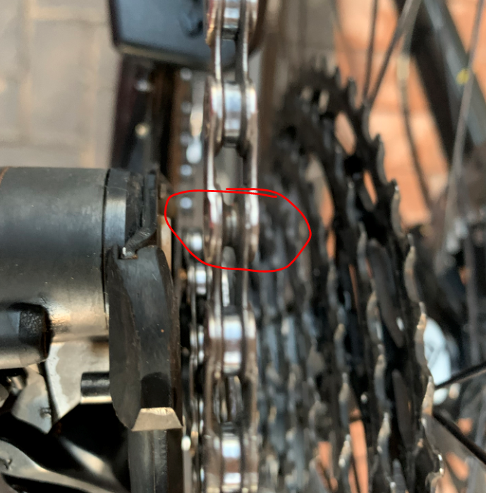

TheoG Posted September 17, 2021 Share Anyone else had this before? A single roller missing on my 12sp Shimano XTR chain with less than 500km on it ... Discovered this unwelcome surprise while busy washing my bike today ... And no its not the quick-link .... . Not sure if I should replace the chain or not, don't think it can do serious damage? DieselnDust, mecheng89 and ChrisF 3 Link to comment Share on other sites More sharing options...
warick_wrx Posted September 17, 2021 Share I would think this could cause damage would rather be safe than sorry. Not sure about your current chain length but is it not possible to do drop the link and add a quick link in there to be safe. Edited September 17, 2021 by warick_wrx Dusty, DieselnDust, ChrisF and 2 others 5 Link to comment Share on other sites More sharing options...

Ernst Kromhout Posted September 17, 2021 Share 2 hours ago, warick_wrx said: I would think this could cause damage would rather be safe than sorry. Not sure about your current chain length but is it not possible to do drop the link and add a quick link in there to be safe. Yes, that’d work Link to comment Share on other sites More sharing options...
Ernst Kromhout Posted September 17, 2021 Share 1 hour ago, Steady Spin said: How even? Its definitely not supposed to do that if it has less than 500kms on it, maybe its a factory fault? Link to comment Share on other sites More sharing options...
TheoG Posted September 18, 2021 Share 11 hours ago, Steady Spin said: How even? My question exactly. Was very befuddled when I saw it, can not even fathom how that happened. Link to comment Share on other sites More sharing options...
TheoG Posted September 18, 2021 Share 9 hours ago, Ernst Kromhout said: Its definitely not supposed to do that if it has less than 500kms on it, maybe its a factory fault? That's probably the only logical explanation, I cant see how a single roller can come of even if it was cracked. Link to comment Share on other sites More sharing options...
TheoG Posted September 18, 2021 Share 12 hours ago, warick_wrx said: I would think this could cause damage would rather be safe than sorry. Not sure about your current chain length but is it not possible to do drop the link and add a quick link in there to be safe. Yes thanks, I think I can get away with the chain a bit shorter. That would be my first course of action. Edited September 18, 2021 by TheoG DieselnDust 1 Link to comment Share on other sites More sharing options...

RobertWhitehead Posted September 18, 2021 Share Just add a roller, I will be able to assist you with that. Hairy 1 Link to comment Share on other sites More sharing options...
warick_wrx Posted September 18, 2021 Share 1 hour ago, RobertWhitehead said: Just add a roller, I will be able to assist you with that. Intresting ! are replacemnt pins availale now for 12 speed chains ? when I looked a while ago I could not find anything. I would definitely not attempt to to reuse a pin. Edited September 18, 2021 by warick_wrx Link to comment Share on other sites More sharing options...
TheoG Posted September 18, 2021 Share 2 hours ago, RobertWhitehead said: Just add a roller, I will be able to assist you with that. 100%, that's exactly what I did, partially pushed out the hollow pin, replaced the roller with one lying around and pressed the pin back in. Still nice and tight, so bob is is your uncle ... . Hairy and Steady Spin 2 Link to comment Share on other sites More sharing options...
Steady Spin Posted September 18, 2021 Share 3 hours ago, warick_wrx said: Intresting ! are replacemnt pins availale now for 12 speed chains ? when I looked a while ago I could not find anything. I would definitely not attempt to to reuse a pin. No such thing exists. I recycled a pin before with no issues. Best to patch in a quicklink. mecheng89 and TheoG 2 Link to comment Share on other sites More sharing options...
warick_wrx Posted September 18, 2021 Share 44 minutes ago, Steady Spin said: No such thing exists. I recycled a pin before with no issues. Best to patch in a quicklink. The pins on the chain are not designed for to be reused ! Link to comment Share on other sites More sharing options...
