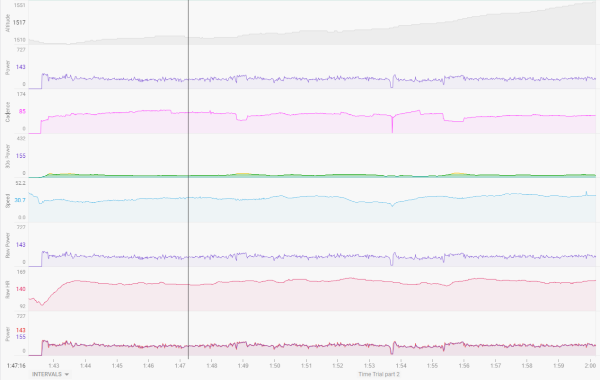

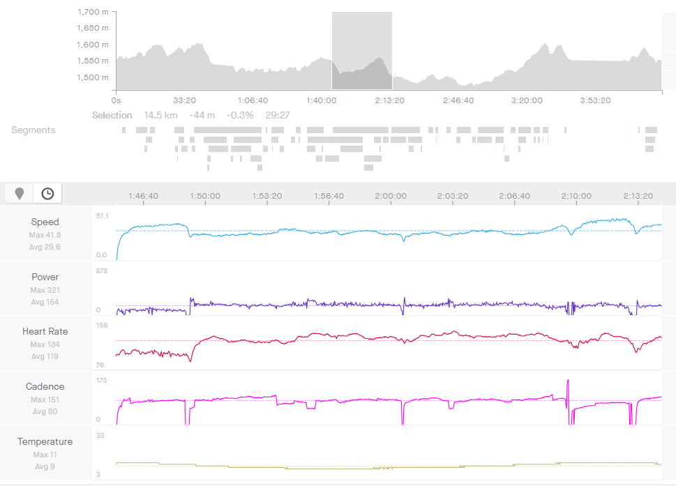

Here is a relatively steady 7-minutes (Intervals on top and Strava below).
The bottom chart (first image) has raw power and a 3s average on one plot (it'sdifficult to see unless you zoom in, and also move the cursor along the timeline). But you can see the point in time has 143 (raw) and 155 (3s) the power, with a lot of change in the raw power for a relatively steady eddie pace).
