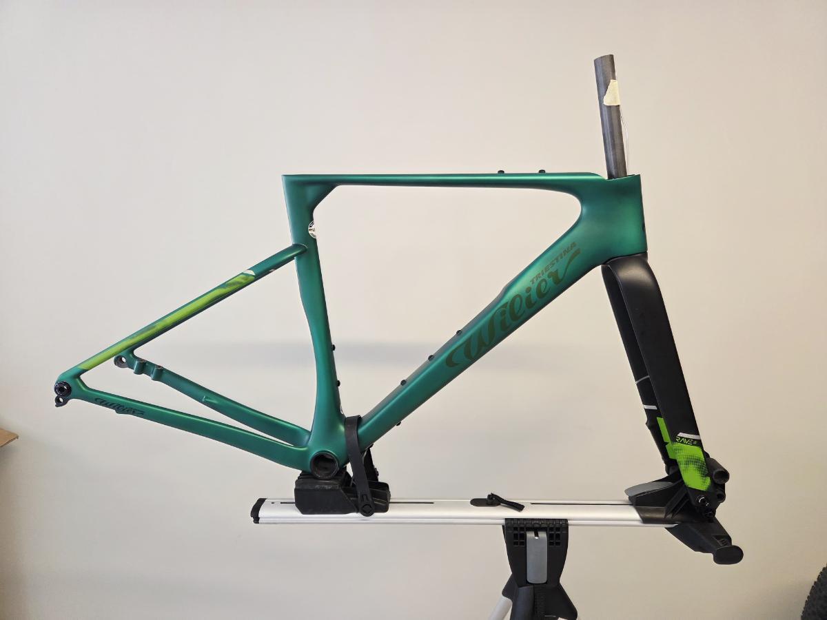

I have the top tier RED XPLR Build.

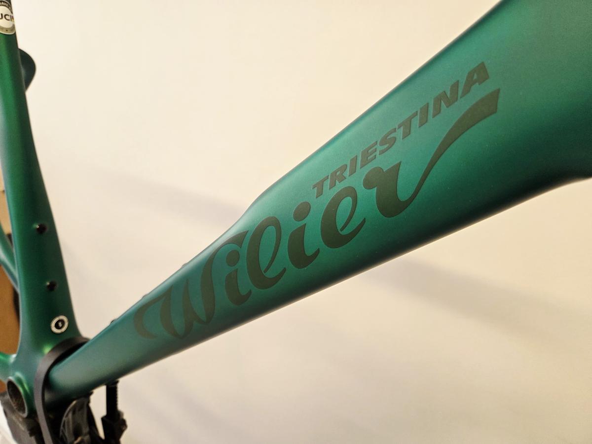

As above i went for the awesome green colour scheme! - pictures do not do this bike justice, its really a rocking colour!
So main the details:
FRAMESET: Wilier Rave ID2 SLR - chosen as it has a whopping 52mm tire clearance, and with that there is an extra 6mm of buffer! can anyone say 2.2 MTB tires - yes please

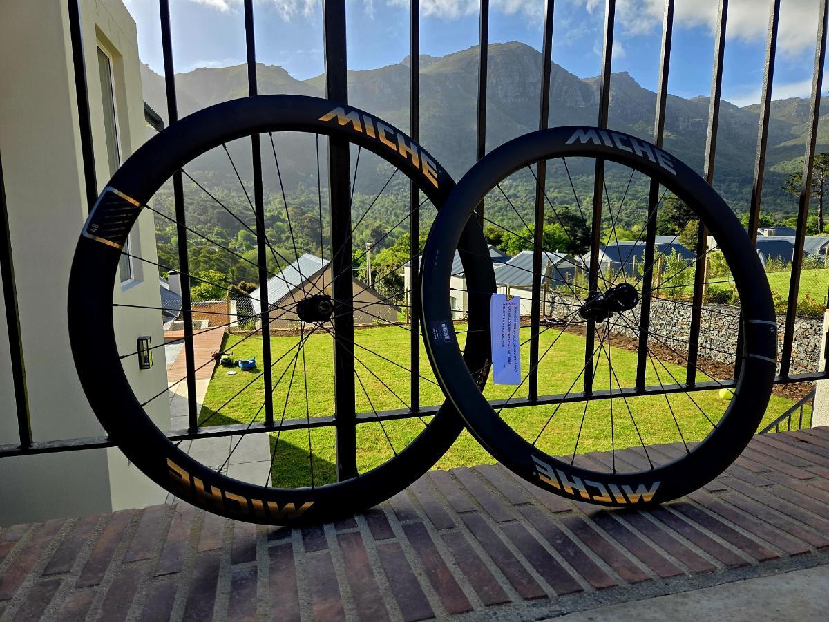

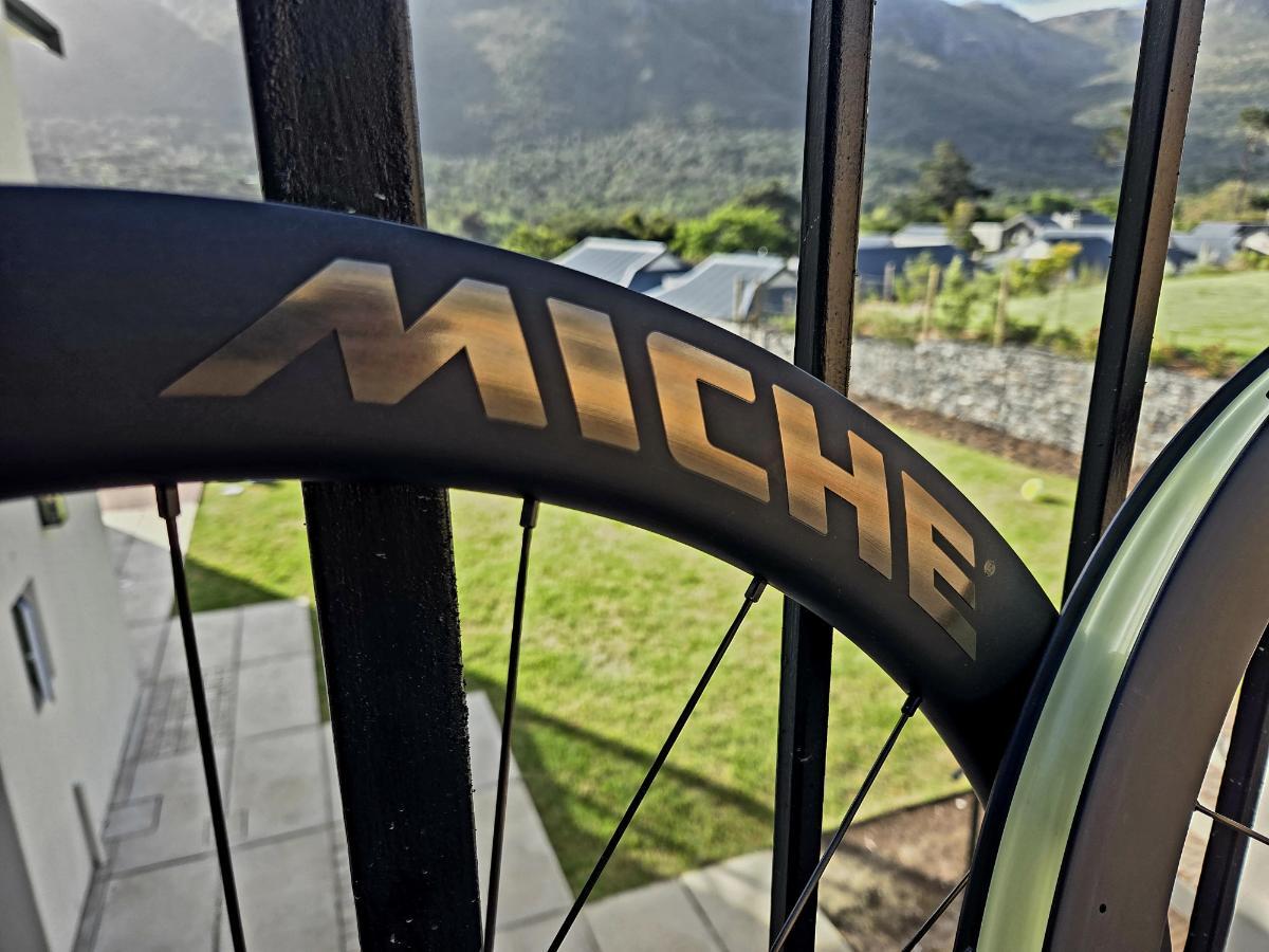

WHEELS: Miche Graff Aero 48 gravel wheels - 27mm internal diameter = ooodles of comfort! i am a little nervous how these will behave in the Western Cape Winds, so these will be tested, and if its a problem i will swap out for something with a little less depth.
I will be making some small changes to the bike build - these will be detailed later on in this thread.
Time for some pics!
HOW GORGEOUS ARE THESE WHEEL GRAPHICS!
1 hour ago, Zebra said:
@Furbz very nice, indeed; can you find a reason to momentarily show us a better pic of the bike with the amazing LUG WORK, in the background, without derailing (derailleur-ing!) this thread?
Tx!
Tx!

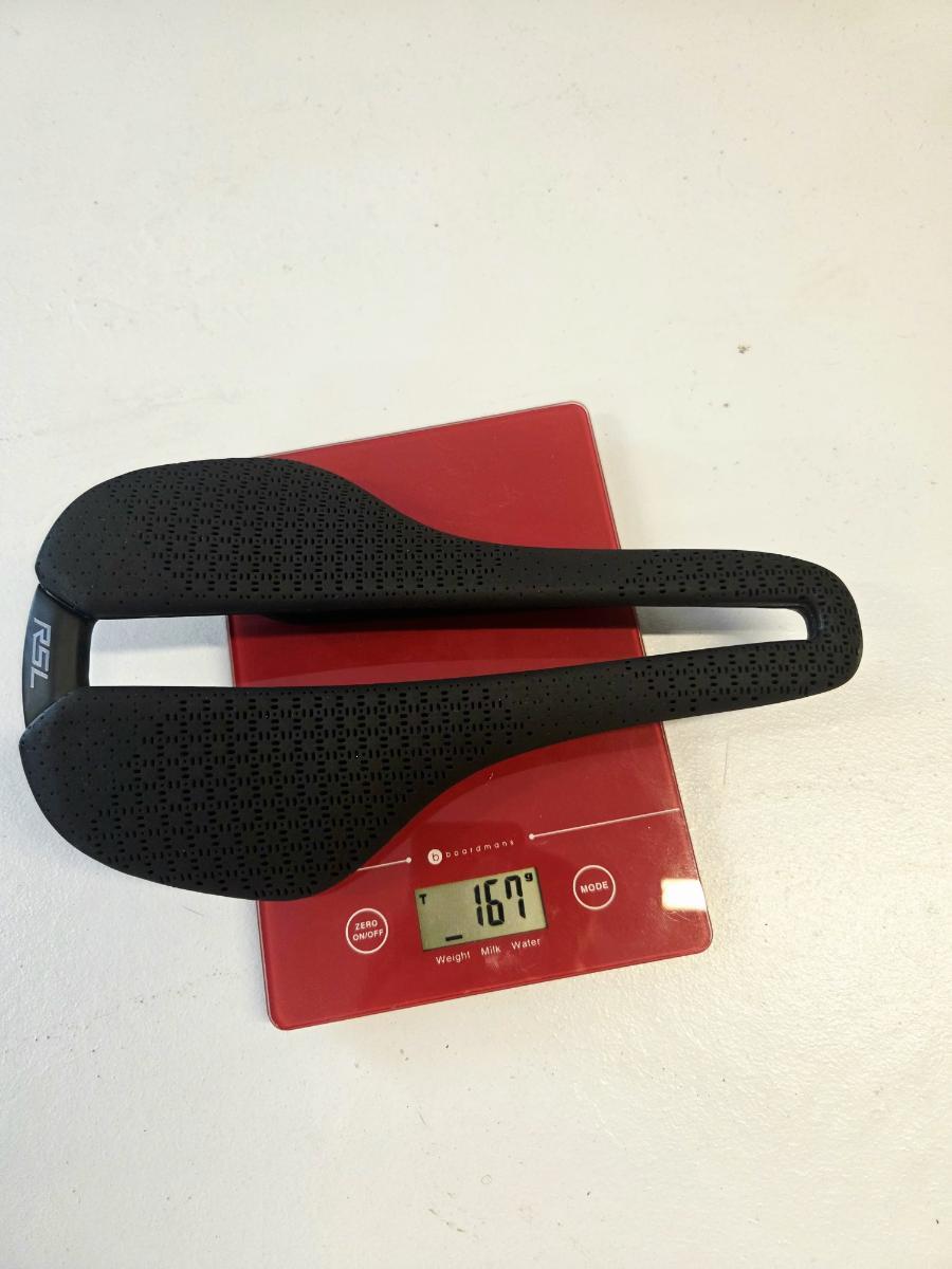

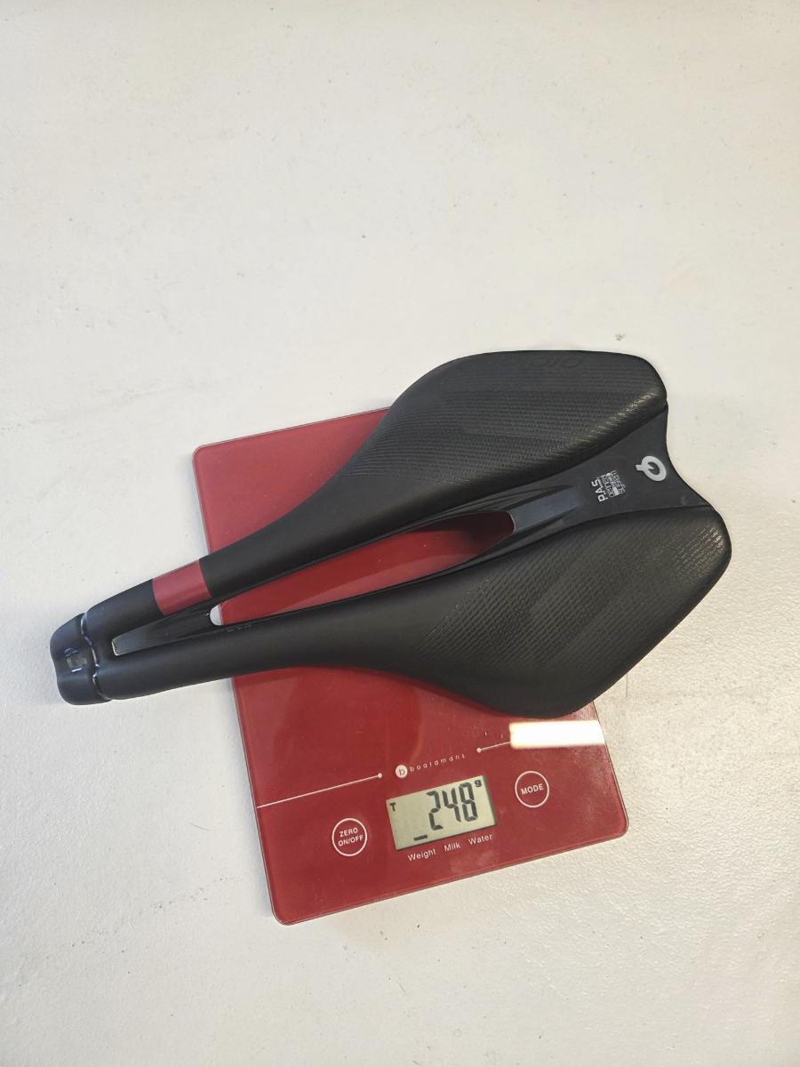

3. The saddle. i'm sure its lovely, but i know my butt. i have found my forever saddle so this one will be removed and replaced with the stunning 3D printed Trek Aeolus RSL AirLoom.
i'll keep you posted on if the 3D saddle is any better than the standard Aeolus RSL.
So far my experimentation with 3D Printed saddles has not impressed me in the slightest. expensive, less comfortable, yes i'm looking at you Selle Italia!
here i ran into a snag, the bike ships only with round rail clamps, so you will need to buy the oval Ritchey version in order to make this move work. Thankfully the new Ritchey agents have stock so again not to much on a problem.
managed to save a fair chunk of weight changing out the saddle. 81grams - this is pretty much standard practice with all stock bikes, they expect you to change it out to your preference.

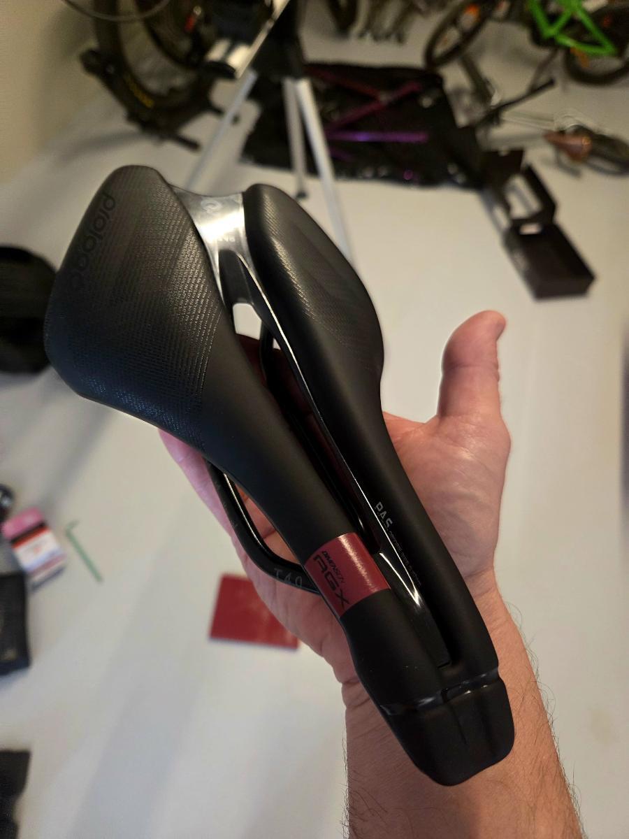

The Stock Prologo saddle is a cracking good looking thing - i'm sure its plenty comfortable, i am however married to my Aeolus.
Stock Weight: 248g
New Weight: 167g

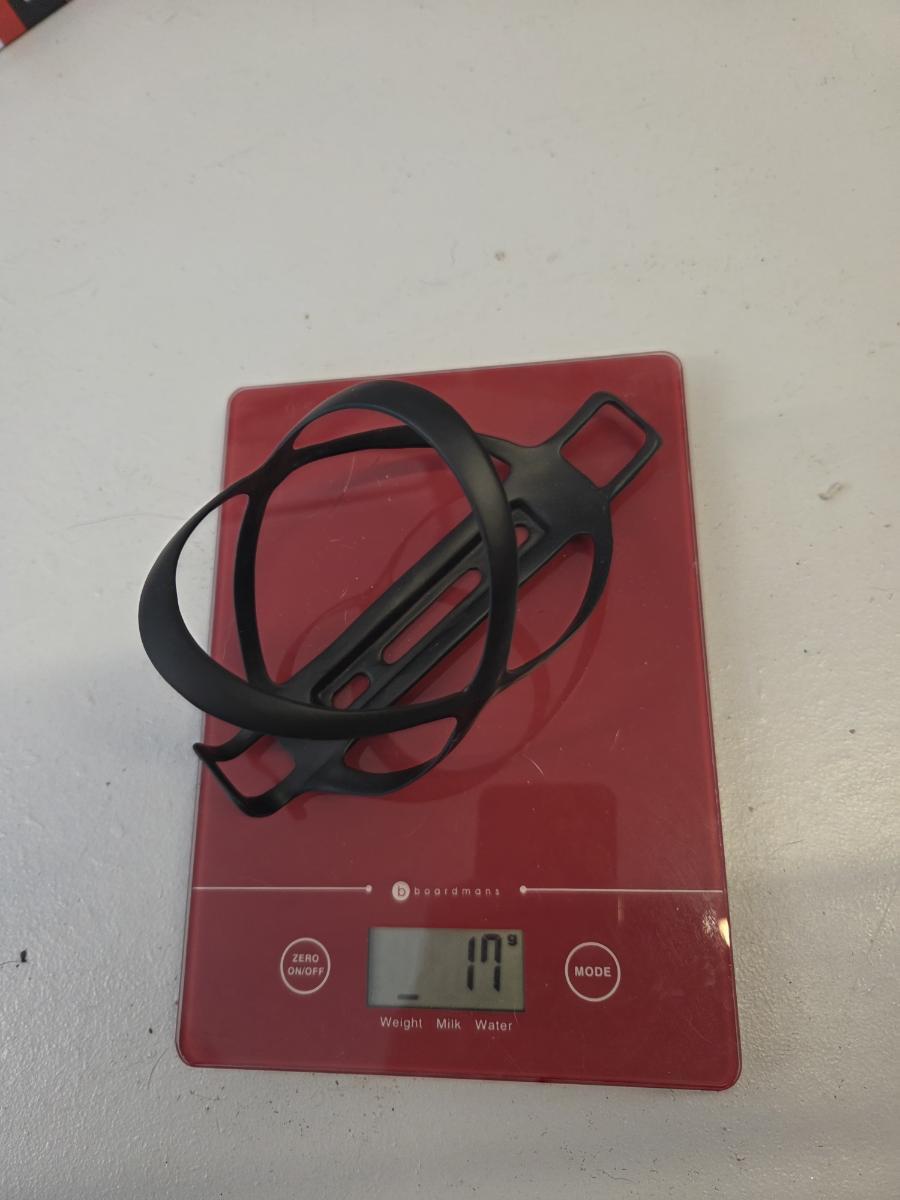

The bottle cages.
While i was expecting Wilier branded cages, i got unbranded extremely lightweight carbon bottle cages instead.
Odd.
I checked in with Pro Touch and yes this is what Wilier will ship if you pay in for additional bottle cages for this bike. A tad disappointing not to get the sexy branded ones in all the online reviews.

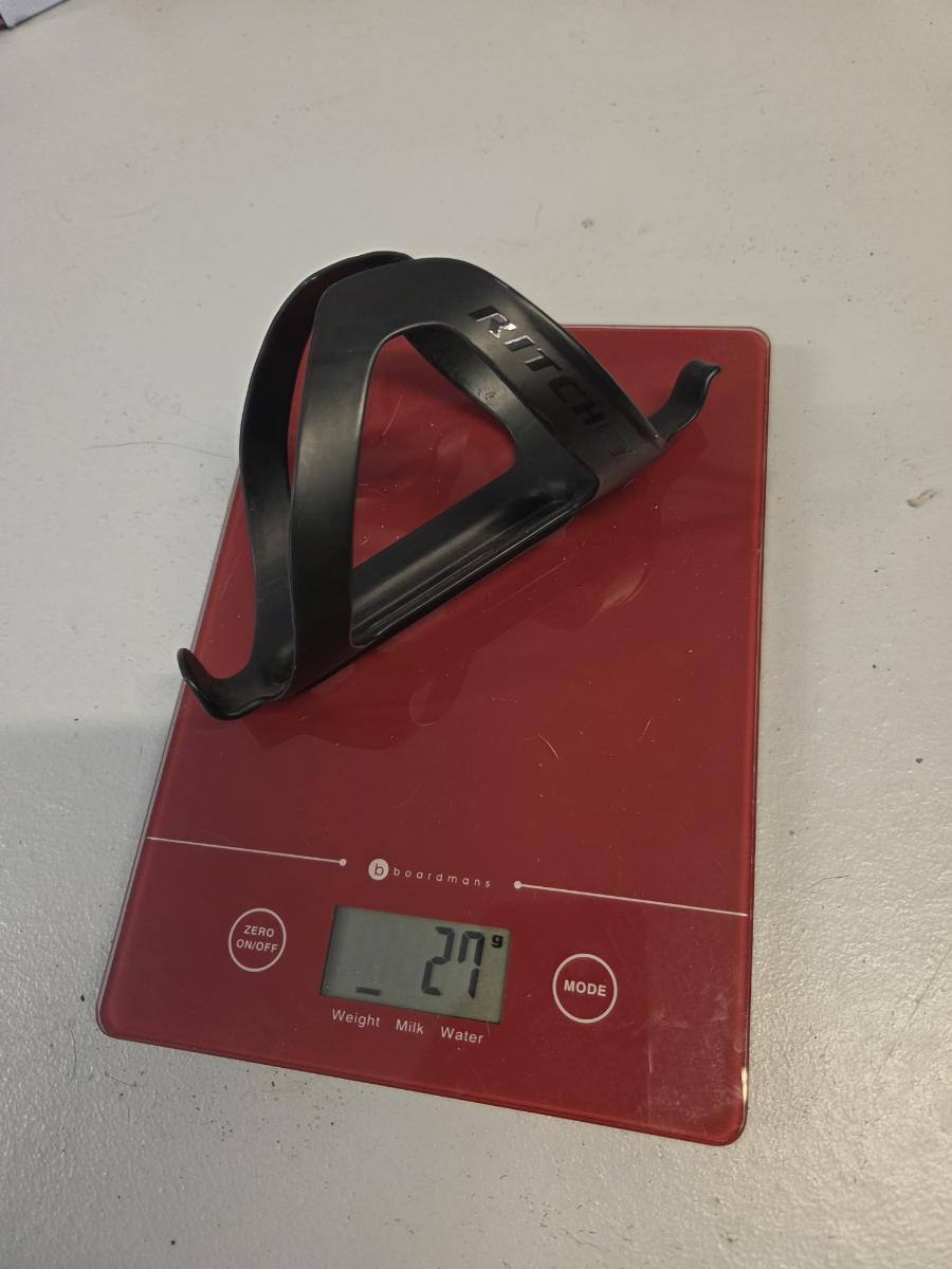

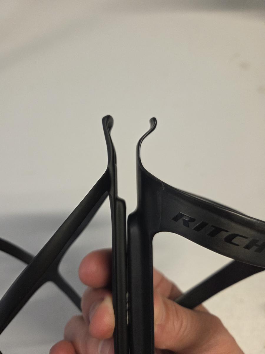

At 17grams they are extremely lightweight, and definitely not designed for gravel riding IMO.
By comparison check out the Ritchey Carbon cages that will be taking their place - the Richey cages have a much better lip for holding a bottle in. The lip on the Wilier supplied cages is almost non-existent.
At 27grams each the Ritchey adds a little weight, but also gives me comfort knowing i have a lot less chance loosing a bottle on a bumpy decent.
