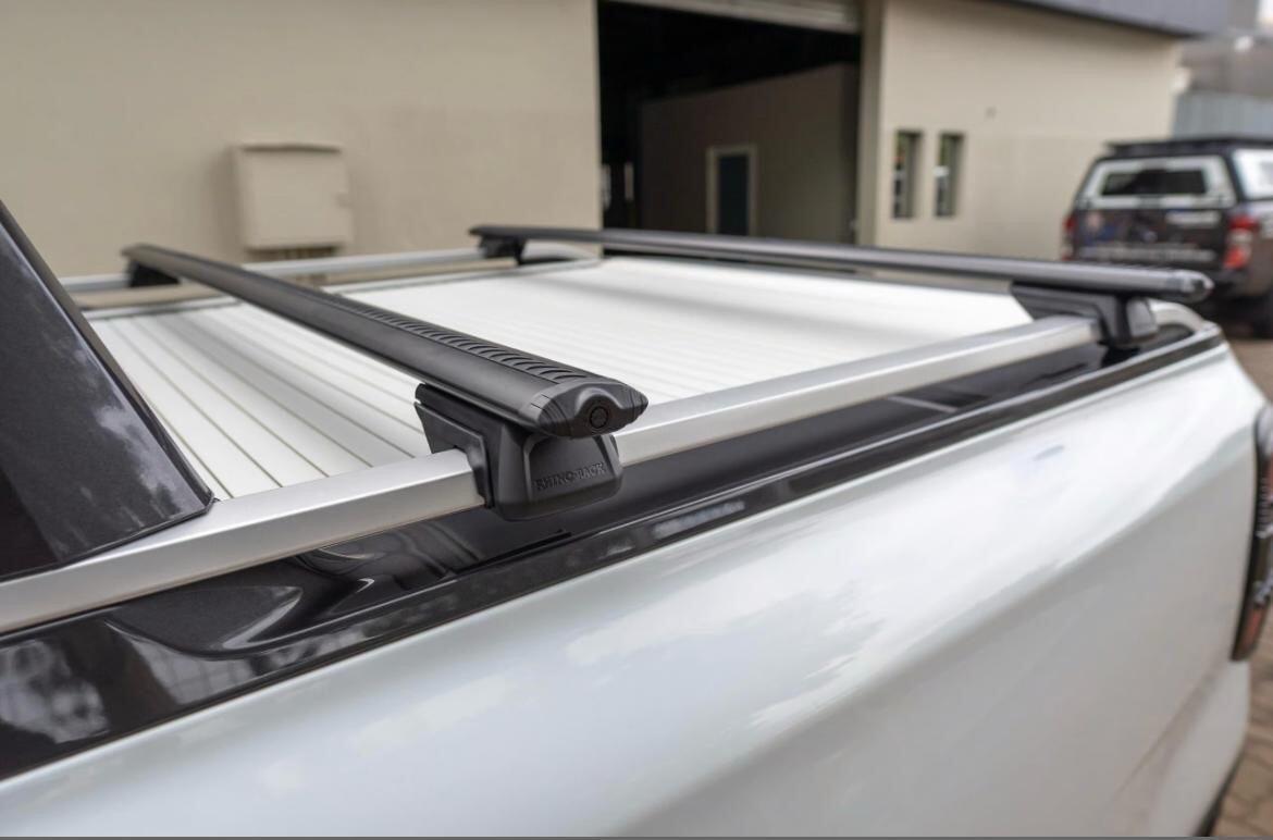

Nudging this thread forward, on the exact same product hunt and surprisingly its not that straightforward.

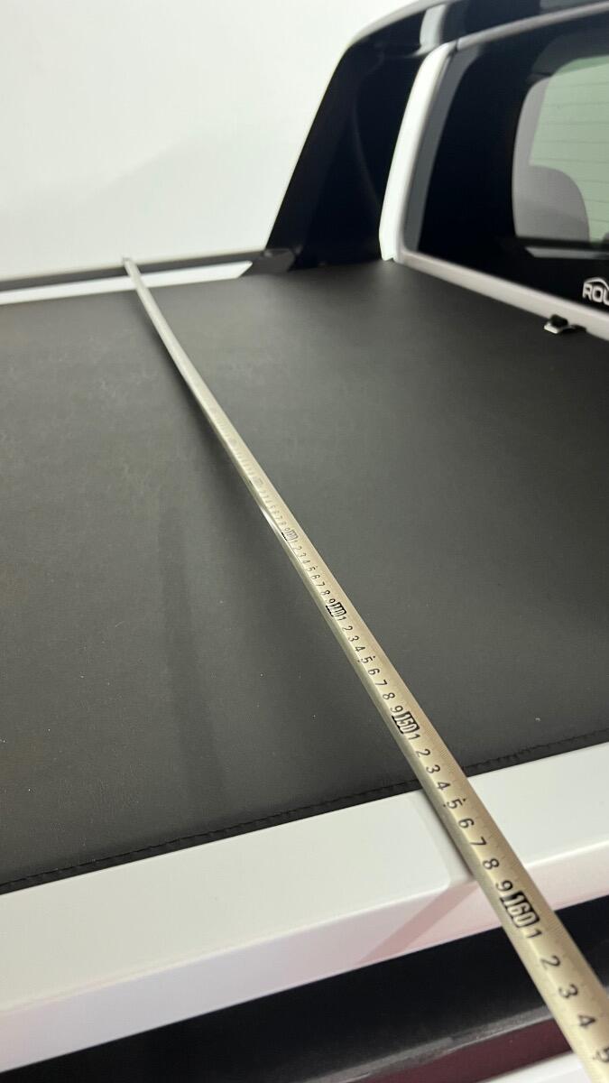

the outer width on the bin rails at 158cm is an issue for the aero rails needed, minimum 165cm-170cm needed.
i am chatting to rhino rack now for a quote for this exact solution, but headed towards R10k before R5-7k for actual bike mounts.
I've hunted on aliexpress and the footpads and bars are under R3k delivered, but max width i can find is 130cm
Has anyone on here got this solution working? And how practical is it with half the bikes rear wheel hanging off the back of the bin?

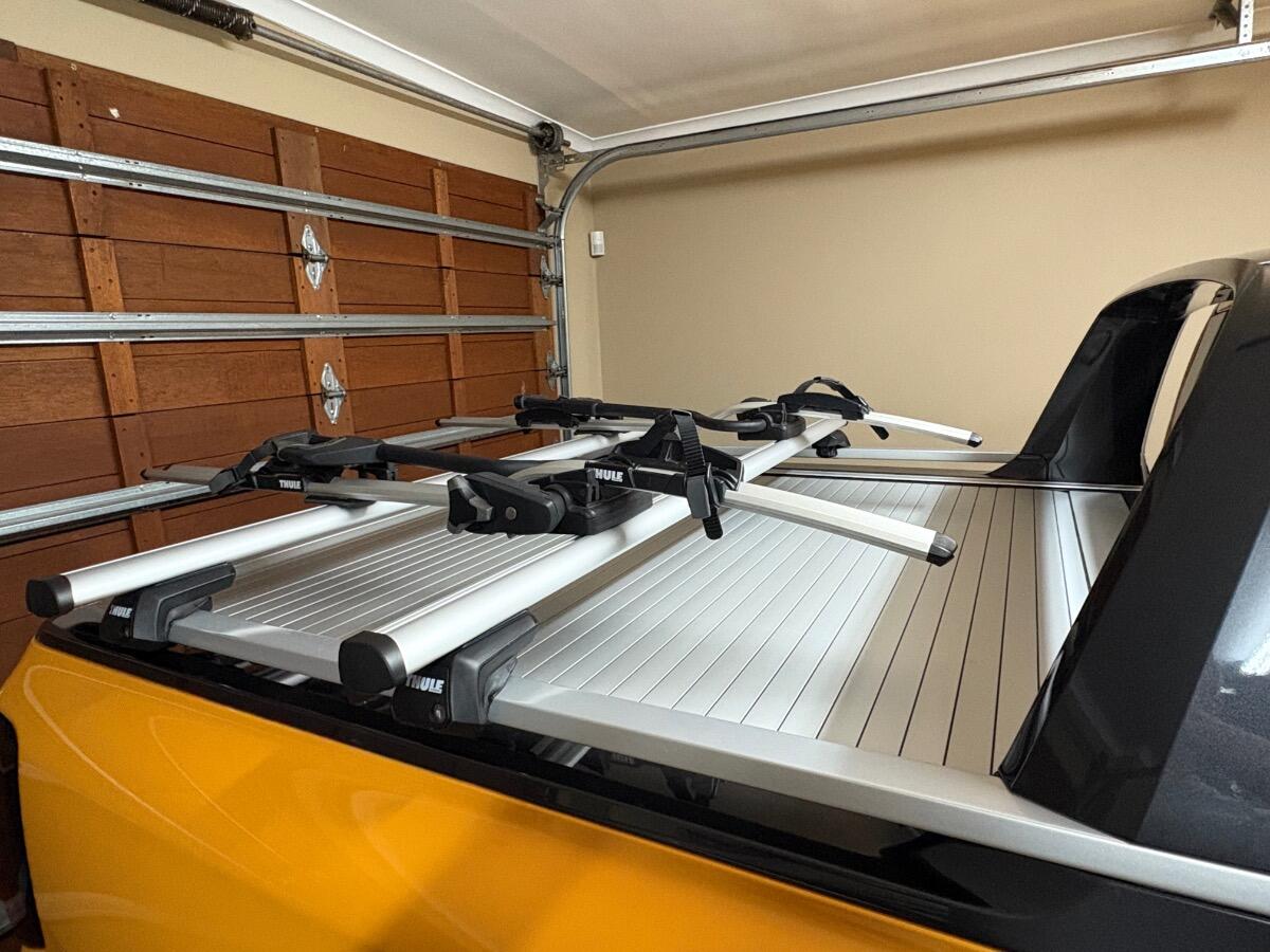

I have both options for my setup on a Ranger Wildtrack, so fit the towbar mounted rack when needed going into underground parking vs popping them on the back above the load box. The spacing meant that I could not use the wing bars from Thule, so had to go for the larger bars which fit with foot packs to the rails. I would have much preferred to leverage off of the t bolt mounting slots on the roller shutter, but could not get the fittings on without breaking some plastic pieces on the roller shutter. So not sure if I was missing something, my Ford dealership were not particularly helpful here either. So opted for this setup, the fairing means that you lose a bit of length and given that I ride XL bikes it was a bit of a fiddle on the rack setup to get everything to fit properly.  My bikes are light, so not too worried in terms of rail spacing, as it is not within suggested Thule spec, but would be cautious if your bikes are heavier. IMG_8054.jpeg.01fccbab86aaa87b50f353e993a1acc3.jpeg
