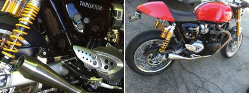

Thug Posted December 7, 2021 Share Do those spoked Adventure bike rims use tubes or not? My Triumph has spoked rims but uses tubes. I'm going to investigate the conversion to tubeless which seems to have been successfully done Link to comment Share on other sites More sharing options...
IceCreamMan Posted December 7, 2021 Share 9 minutes ago, Thug said: Do those spoked Adventure bike rims use tubes or not? My Triumph has spoked rims but uses tubes. I'm going to investigate the conversion to tubeless which seems to have been successfully done GS is tubeless. Most spoked wheels now are tubeless I believe on big adventure bikes, worth converting I reckon. And it’s simple enough to do too. You going to use tubeless tyres anyway might was well save the rolling mass of tubes. And I guess tubes increase heat which is not a good thing either. Edited December 7, 2021 by IceCreamMan Thug 1 Link to comment Share on other sites More sharing options...
Hairy Posted December 7, 2021 Share They may as well make all new spoked rims tubeless, just makes sense. You can always default to a tube if the poo poo really hits the fan on the tyre and you need a gator and tube to get out of the bush at a limp? Link to comment Share on other sites More sharing options...
Thug Posted December 7, 2021 Share 3M make a tape that has been successfully used. https://www.3m.com/3M/en_US/p/d/b40068325/ Just a question of making sure the spokes have some type of thread locker on them and that the ends are nice and smooth. Link to comment Share on other sites More sharing options...
