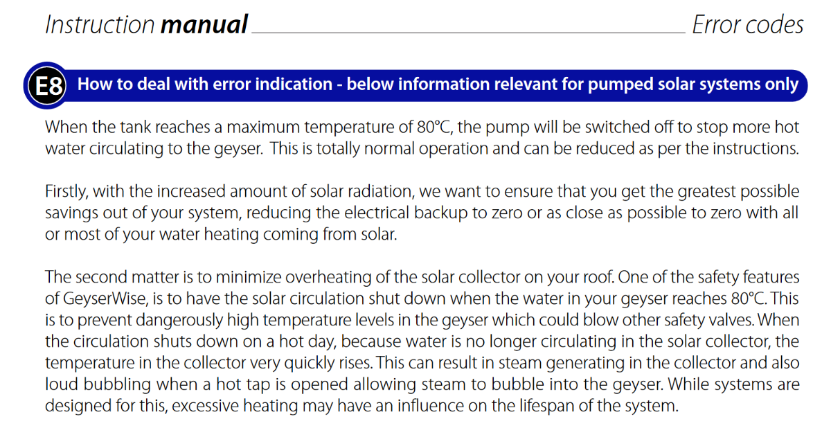

It’s potentially dangerous to someone just turning on a hot water tap. Like a child would do.
For sure, something to factor into the decision if one was going that route (Geyser or children!). Your initial comment indicated that those high temps didn't seem right and I'm just explaining the reasoning, for better or worse. From the Geyserwise Delta T manual:
You can adjust the cutout temp.
Personally I'm more afraid of the black widows in my house than the hot water tap.
